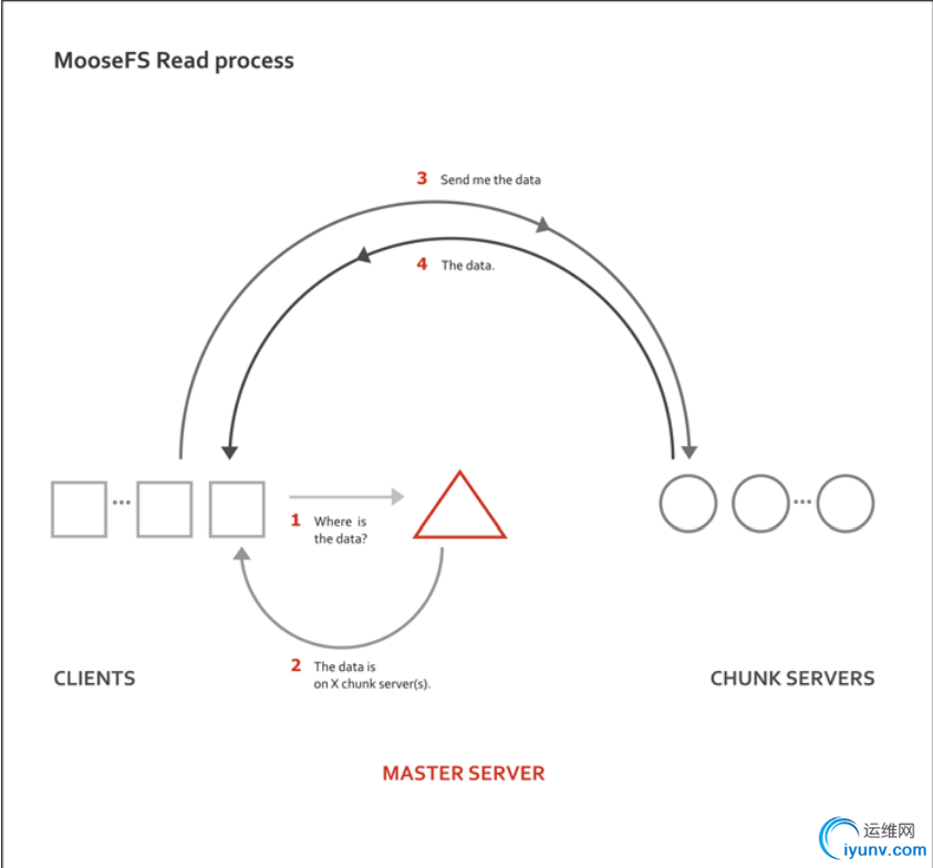

MFS概论与读写过程
  MFS的官方网站是http://www.moosefs.org,我们可以从这里获取权威的帮助信息,官方MFS网络组成以及原理如下所示:
MFS Read Process:

  All file operations on a client computer that has mounted MooseFS are exactly the same as they would be with other file systems. The operating system kernel transfers all file operations to the FUSE module, which communicates with the mfsmount process. The mfsmount process communicates through the network subsequently with the managing server and data servers (chunk servers). This entire process is fully transparent to the user.
  mfsmount communicates with the managing server every time an operation on file metadata is required:
  • creating files
  • deleting files
  • reading directories
  • reading and changing attributes
  • changing file>
  • at the start of reading or writing data
  • on any access to special files on MFSMETA
  mfsmount uses a direct connection to the data server (chunk server) that stores the>  Furthermore, data servers (chunk servers) communicate with each other to replicate data in order to achieve the appropriate number of copies of a file on different machines.
  通过上面官网的解释,我相信大家应该指定MFS一个工作流程了。
