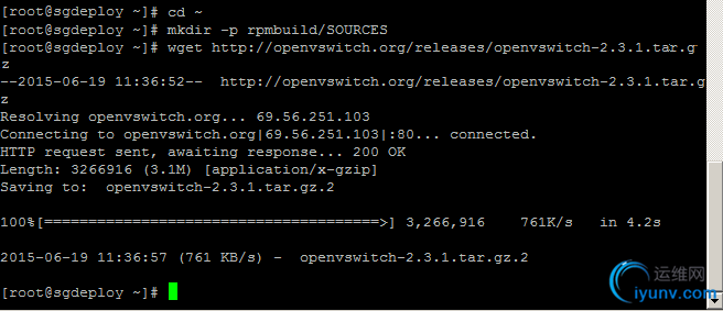

  Create a directory to download the Open vSwitch tar to (You can find the most recent OVS here:http://openvswitch.org/download/):
  cd ~
mkdir -p rpmbuild/SOURCES
wget http://openvswitch.org/releases/openvswitch-2.3.1.tar.gz
  tar xvfz openvswitch–2.3.1.tar.gz
  cd openvswitch–2.3.1/
cp ../openvswitch–2.3.1.tar.gz ~/rpmbuild/SOURCES/
cp rhel/openvswitch-kmod.files ~/rpmbuild/SOURCES/

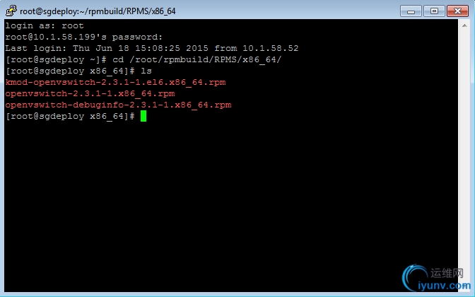

  Then to build the rpms. This can take a few minutes:
  rpmbuild -bb rhel/openvswitch.spec
rpmbuild -bb rhel/openvswitch-kmod-rhel6.spec
  ※如果没有rpmbuild命令,则yum install rpm-build 安装
  ※ openssl-devel is needed by openvswitch-2.5.0-1.x86_64,如果 没有openssl-devel,则yum install openssl-devel 安装
  Now the rpms are sitting on my deployment server ready to be copied to my KVM nodes.

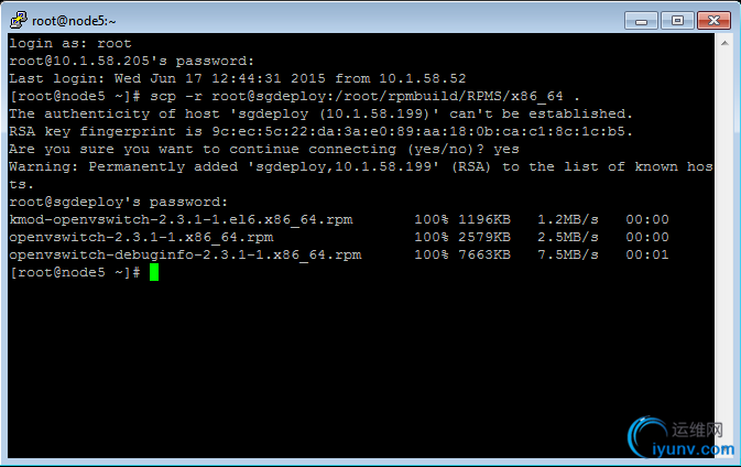

  Copy the Open vSwitch rpms to the KVM node, using SCP.
  scp -r root@sgdeploy:/root/rpmbuild/RPMS/x86_64 .
  Change directory to x86_64/ by
cd x86_64/

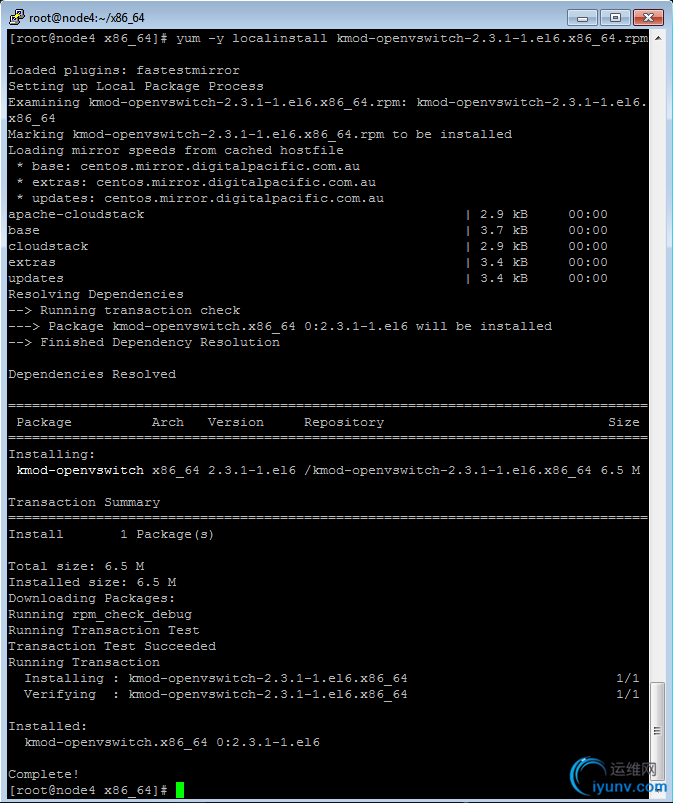

  Then install kmod-openvswitch-2.3.1-1.el16.x86_64.rpm using
yum -y localinstall kmod-openvswitch-2.3.1-1.e16.x86_64.rpm

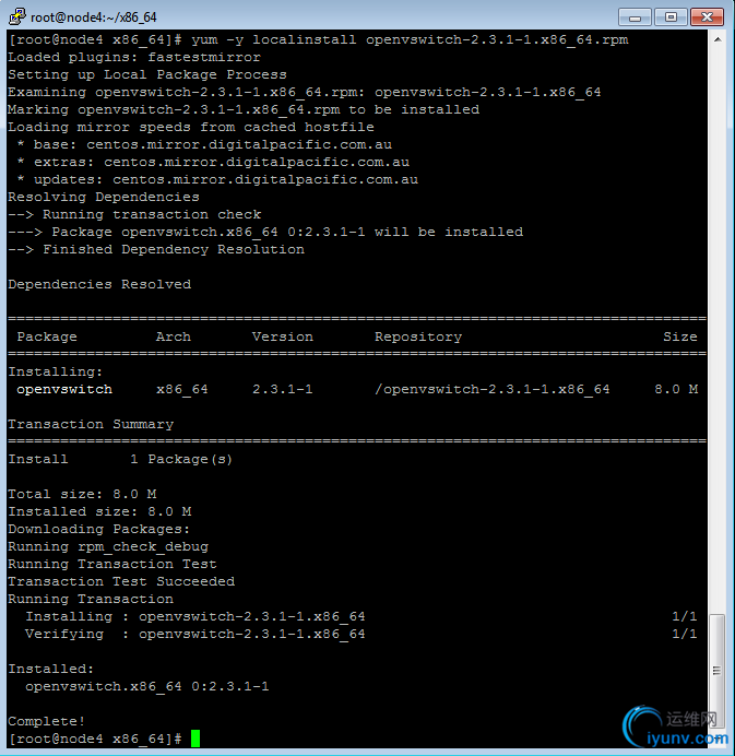

  Install openvswitch-2.3.1-1.x86_64.rpm using
yum -y localinstall openvswitch-2.3.1-1.x86_64.rpm
