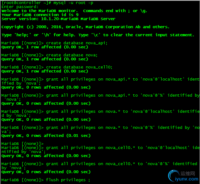

        ①  为了创建数据库,必须完成这些步骤:
        mysql -u root -p
        create database nova_api;
        create database nova;
        create database nova_cell0;
        grant all privileges on nova_api.* to 'nova'@'localhost' identified by 'nova';
        grant all privileges on nova_api.* to 'nova'@'%' identified by 'nova';
        grant all privileges on nova.* to 'nova'@'localhost' identified by 'nova';
        grant all privileges on nova.* to 'nova'@'%' identified by 'nova';
        grant all privileges on nova_cell0.* to 'nova'@'localhost' identified by 'nova';
        grant all privileges on nova_cell0.* to 'nova'@'%' identified by 'nova';
        flush privileges ;
        exit

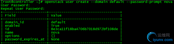

        创建nova用户:
        openstack user create --domain default --password-prompt nova

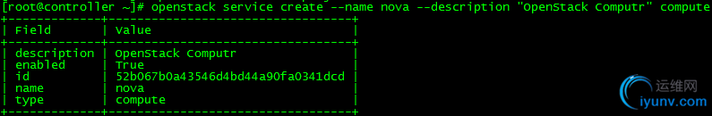

        创建nova服务实体
        openstack service create --name nova --description "OpenStack Computr" compute

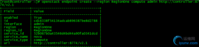

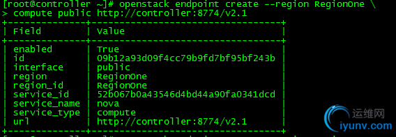

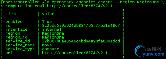

        ④  创建计算API服务端点
        openstack endpoint create --region RegionOne compute public http://controller:8774/v2.1
        openstack endpoint create --region RegionOne compute internal http://controller:8774/v2.1
        openstack endpoint create --region RegionOne compute admin http://controller:8774/v2.1

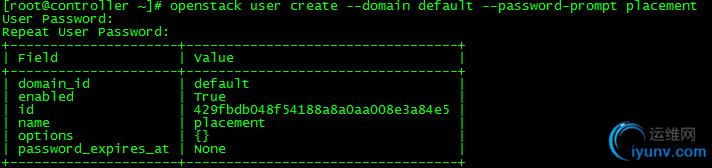

        ⑤  创建placement service的一个用户placement
        openstack user create --domain default --password-prompt placement

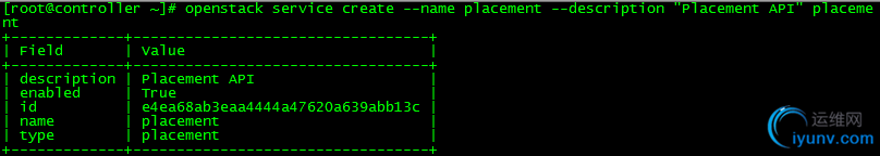

        ⑦  创建placement API服务目录
        openstack service create --name placement --description "Placement API" placement

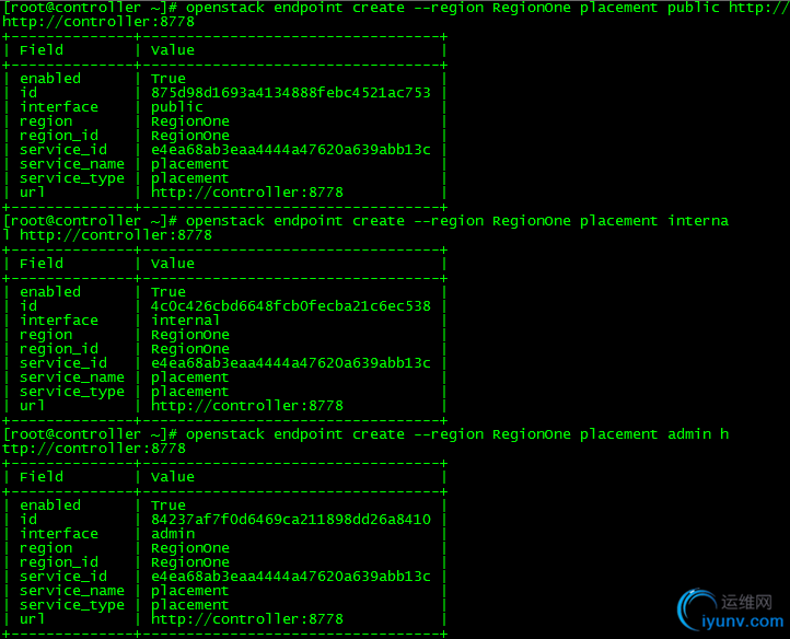

        ⑧  创建placement API 服务端点
        openstack endpoint create --region RegionOne placement public http://http://controller:8778
        openstack endpoint create --region RegionOne placement internal http://controller:8778
        openstack endpoint create --region RegionOne placement admin http://controller:8778

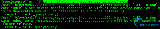

        ⑥  填充nova数据库
             su -s /bin/sh -c "nova-manage db sync" nova

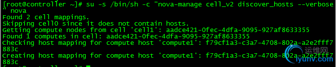

        2. 发现compute主机列表:
        su -s /bin/sh -c "nova-manage cell_v2 discover_hosts --verbose" nova
        注意:
                当你添加新的计算节点,您必须运行nova-manage cell_v2  discover_hosts控制器节点上注册新计算节点

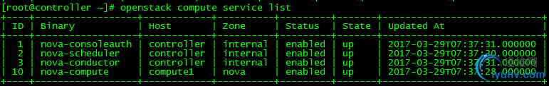

    2. 列出服务组件:
        该输出显示三个服务组件在控制节点上启用,一个服务组件在计算节点上启用。

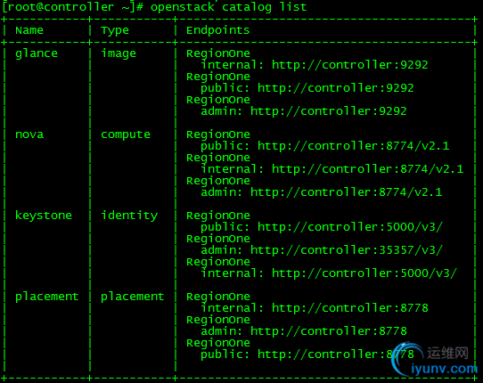

    3. 在标识服务API端点列表与身份验证连接服务:
        注意:下面端点列表可能不同,这取决于OpenStack的安装组件。在这个输出忽略任何警告。
        openstack catalog list
