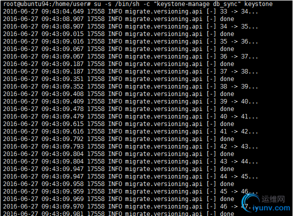

(5)填充keystone数据库
$  su -s /bin/sh -c "keystone-manage db_sync" keystone   DSC0000.png
  修这里最好切换至root用户同步,否者会同步不成功。

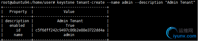

a.创建admin租户
$  keystone tenant-create --name admin --description "Admin Tenant"

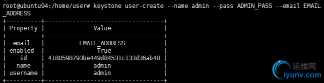

b.创建admin用户
keystone user-create --name admin --pass <ADMIN_PASS> --email EMAIL_ADDRESS
$  keystone user-create --name admin --pass ADMIN_PASS --email EMAIL_ADDRESS   DSC0002.png

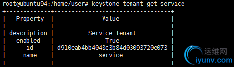

  e.创建service租户
$  keystone tenant-create --name service --description "Service Tenant"

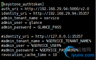

b.在 [keystone_authtoken] 和 [paste_deploy] 部分, 修改配置:
auth_uri = http:// <192.168.1.1>:5000/v2.0
identity_uri = http:// <192.168.1.1>:35357
admin_tenant_name = service
admin_user = glance
admin_password = <GLANCE_PASS>
auth_uri = http://192.168.29.94:5000/v2.0
identity_uri = http://192.168.29.94:35357
admin_user = glance
admin_password = GLANCE_PASS
c.在注释掉下面的内容
#identity_uri = http://127.0.0.1:35357
#admin_tenant_name = %SERVICE_TENANT_NAME%
#admin_user = %SERVICE_USER%
#admin_password = %SERVICE_PASSWORD%

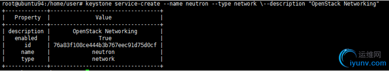

c.创建neutron 服务实例
$  keystone service-create --name neutron --type network \--description "OpenStack Networking"

注意,这里SERVICE_TENANT_ID是keystone service 租户id 。nova_pass是nova用户密码,这是使用的是默认密码, SERVICE_TENANT_ID的查询方式如下:
$  source admin_creds

注:用户名和密码是由keystone创建的。命令为:  keystone user-create --name admin --pass ADMIN_PASS --email EMAIL_ADDRESS
