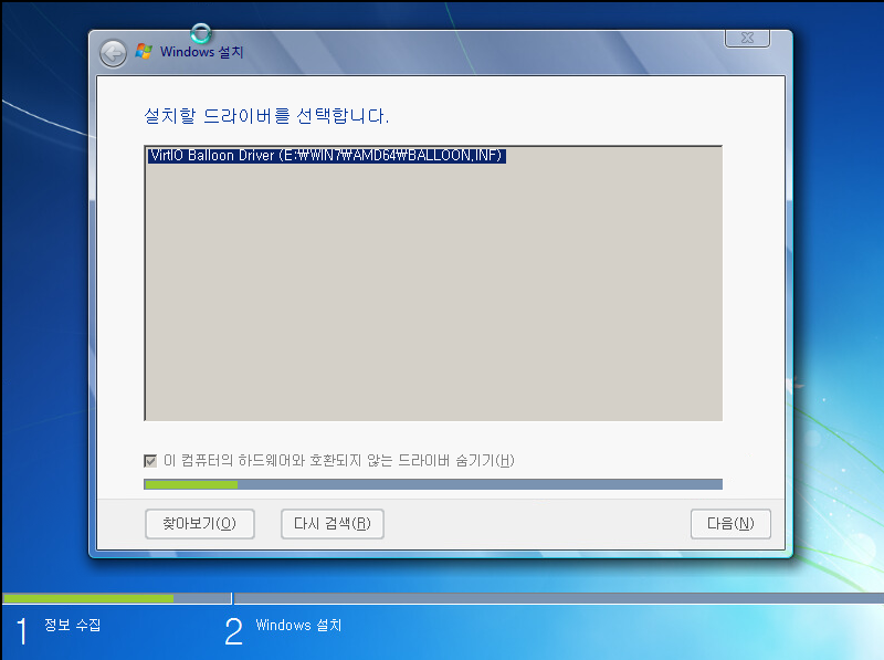

Create new virtual machine (windows 7)
Add Windows 7 ISO file and virtIO driver file(Load VirtIO driver)

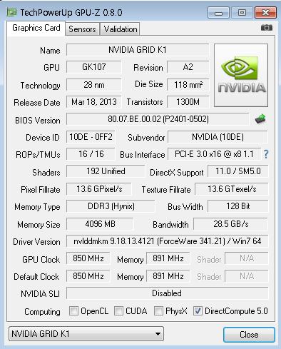

  • Start win7 (virtual machine)
  • Install NVIDIA graphic driver 341.21
  6. Accecc to Virtual Machine by Remote Desktop
  • xxx.xxx.xxx.x:2222
  • Run GPU-Z
  • Run Specviewperf 11
