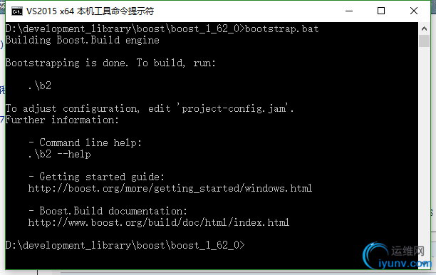

  boost库自带了bootstrap脚本来生成一个构建工具b2。打开命令行直接执行即可。
D:\development_library\boost\boost_1_62_0>bootstrap.bat --help
Building Boost.Build engine
Failed to build Boost.Build engine.
Please consult bootstrap.log for further diagnostics.
You can try to obtain a prebuilt binary from
  http://sf.net/project/showfiles.php?group_id=7586&package_id=72941
Also, you can file an issue at http://svn.boost.org
Please attach bootstrap.log in that case.
  这里出现了Failed to build Boost.Build engine.错误,解决办法很简单,使用VS 2015 命令行提示符来执行即可。
