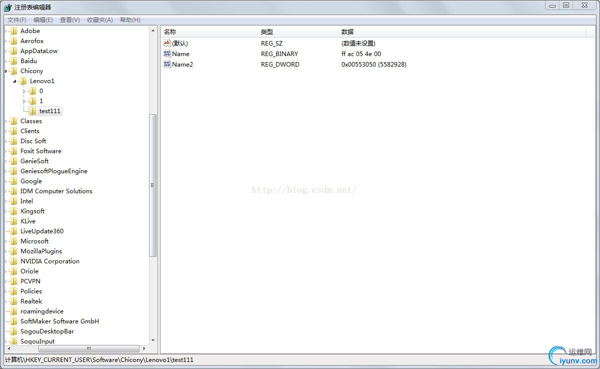

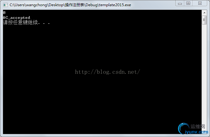

  • #include <iostream>
  • #include <algorithm>
  • #include <cmath>
  • #include <vector>
  • #include <string>
  • #include <cstring>
  • #include <atlbase.h>
  • #include <Windows.h>
  • #pragma warning(disable:4996)
  • using namespace std;
  • void read_dword()//读取操作表,其类型为DWORD
  •     HKEY hKEY;//定义有关的键,在查询结束时关闭
  •     //打开与路径data_Set相关的hKEY
  •     LPCTSTR data_set = _T("Software\\Chicony\\Lenovo1");
  •     //访问注册表,hKEY则保存此函数所打开的键的句柄
  •     if (ERROR_SUCCESS == ::RegOpenKeyEx(HKEY_CURRENT_USER, data_set, 0, KEY_READ, &hKEY))
  •         DWORD dwValue;//长整型数据,如果是字符串数据用char数组
  •         DWORD dwSize = sizeof(DWORD);
  •         DWORD dwType = REG_DWORD;
  •         if (::RegQueryValueEx(hKEY, _T("123"), 0, &dwType, (LPBYTE)&dwValue, &dwSize) != ERROR_SUCCESS)
  •             cout << "错误:无法查询有关的注册表信息" << endl;
  •         cout << dwValue << endl;
  •     ::RegCloseKey(hKEY);
  • void read_reg_sz()//读取操作表,其类型为REG_SZ
  •     HKEY hkey;
  •     if (ERROR_SUCCESS == ::RegOpenKeyEx(HKEY_CURRENT_USER, data_set, 0, KEY_READ, &hkey))

  • void write_dword()//在\Software\\Chicony\\Lenovo1文件夹下写入一个test111的子键,设置其名称为Name,其值为6
  •     HKEY hkey;//定义有关的hkey,在查询结束时要关闭
  •     HKEY hTempKey;
  •     DWORD dwValue = 6;
  •     LPCTSTR data_set= _T("Software\\Chicony\\Lenovo1");
  •     if (ERROR_SUCCESS == RegOpenKeyEx(HKEY_CURRENT_USER, data_set, 0, KEY_SET_VALUE, &hkey))
  •         if (ERROR_SUCCESS == ::RegCreateKey(hkey, _T("test111"), &hTempKey))
  •             if (ERROR_SUCCESS != ::RegSetValueEx(hTempKey, _T("Name"), 0, REG_DWORD, (CONST BYTE*)&dwValue, sizeof(DWORD)))
  •                 cout <<"写入注册表失败"<< endl;

  • void write_binary()
  •     HKEY hkey;
  •     HKEY hTempKey;
  •     BYTE m_name[10];
  •     memset(m_name, 0, sizeof(m_name));
  •     m_name[0] = 0xff;
  •     m_name[1] = 0xac;
  •     m_name[2] = 0x05;
  •     m_name[3] = 0x4e;
  •     if (ERROR_SUCCESS == ::RegOpenKeyEx(HKEY_CURRENT_USER, data_set, 0, KEY_SET_VALUE, &hkey))
  •         if (ERROR_SUCCESS==::RegCreateKey(hkey,_T("test111"),&hTempKey))
  •             if (ERROR_SUCCESS != ::RegSetValueEx(hTempKey, _T("Name"), 0, REG_BINARY, (unsigned char *)m_name, 5))
  •                 cout << "写入错误" << endl;
  •     ::RegCloseKey(hkey);

  • int main()
  •     read_dword();
  •     read_reg_sz();
  •     write_reg_sz();
  •     write_binary();
  •     delete_value();
  •     delete_key();
  •     system("pause");
  •     return 0;
