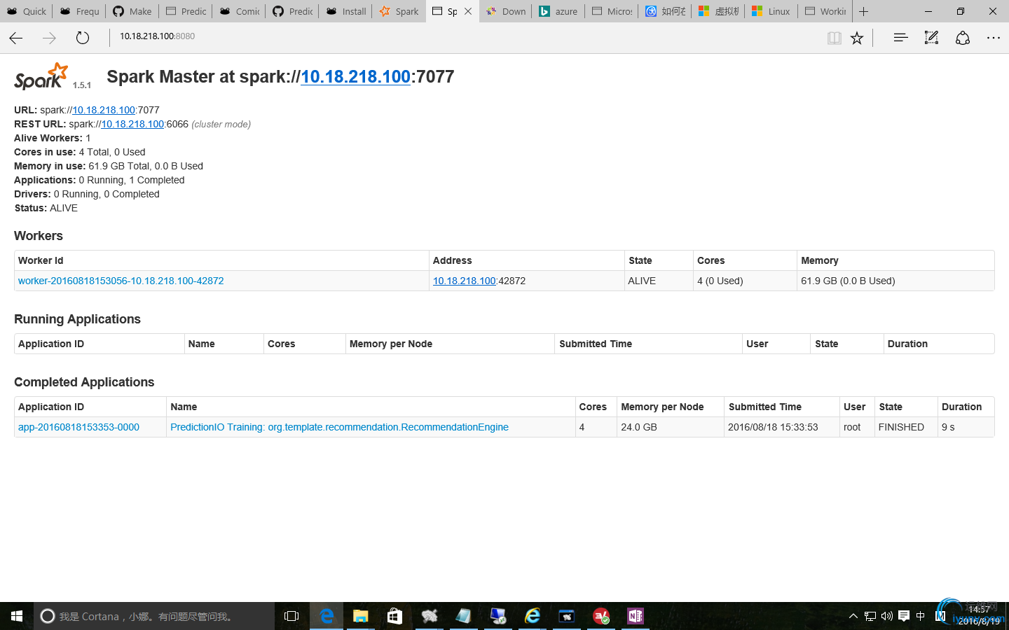

  通过 PredictionIO 内置的脚本启动 Spark 进行模型训练时总是出现问题,所以采用手动启动 Spark 集群的方式规避此问题。
  You can start a standalone master server by executing:
PredictionIO-0.9.6/vendors/spark-1.5.1-bin-hadoop2.6/sbin/start-master.sh
  Once started, the master will print out a spark://HOST:PORT URL for itself, which you can use to connect workers to it, or pass as the &quot;master&quot; argument to SparkContext. You can also find this URL on the master's web UI, which is http://localhost:8080 by default.
Similarly, you can start one or more workers and connect them to the master via:
./sbin/start-slave.sh <master-spark-URL>
  即
PredictionIO-0.9.6/vendors/spark-1.5.1-bin-hadoop2.6/sbin/start-slave.sh spark://localhost:8080
  Once you have started a worker, look at the master's web UI (http://localhost:8080 by default). You should see the new node listed there, along with its number of CPUs and memory (minus one gigabyte left for the OS).

  在上文中提到 Spark 集群是由我们手工启动的,因此在模型训练时指定 Spark master UI 和运行时内存参数。
To train your engine, run the following command:
pio train -- --master spark://localhost:7077 --driver-memory 16G --executor-memory 24G
