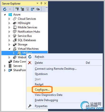

  启动VS连接Azure,竟然找不到图中Azure的管理UI,细想一下也对,不是所有的VS使用者都需要操作Azure,这个Azure的管理UI应该是VS的一个Plugin。

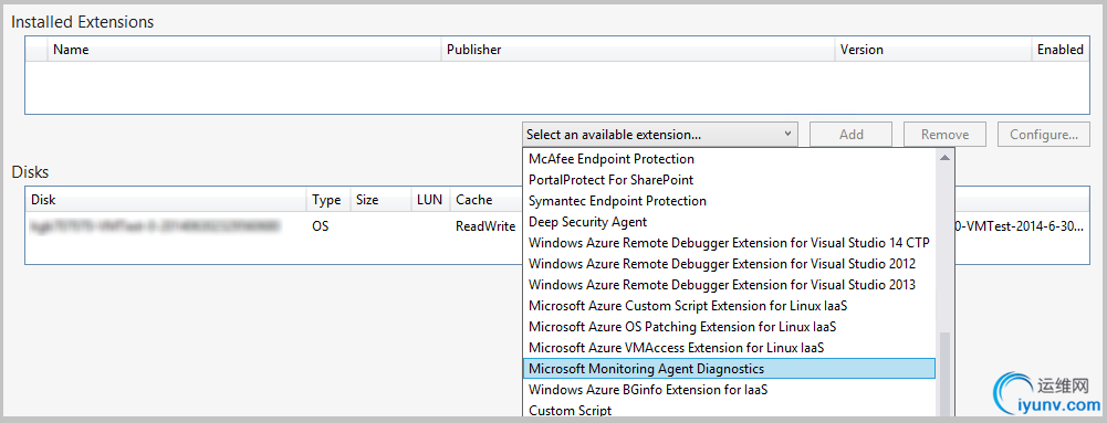

  咨询了搞大数据的朱哥,发给我一个在线安装程序:选择安装Microsoft Azure SDK for .net(VS 2015)-2.8.1

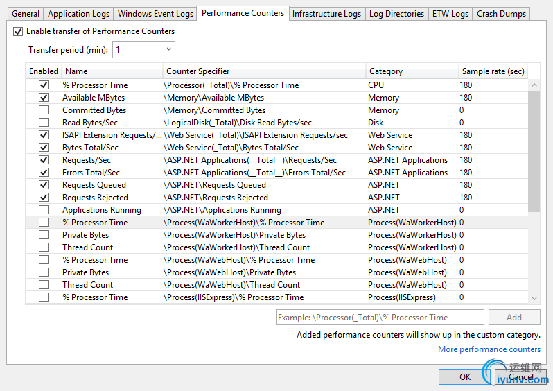

  安装完成后,Azure的管理菜单出来了,然后选择要监控的虚拟机,添加Microsoft Monitoring Agent Diagnostics,Configure,监控自定义性能计数器,然后保存:

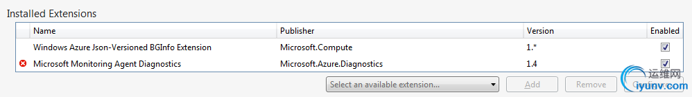

  重新刷新后,扩展启用报错了:
  错误信息:Microsoft.Azure.Diagnostics.IaaSDiagnostics, version 1.4.2.1) with exception Command C:\Packages\Plugins\Microsoft.Azure.Diagnostics.IaaSDiagnostics\1.4.2.1\DiagnosticsPluginLauncher.exe of Microsoft.Azure.Diagnostics.IaaSDiagnostics has exited with code -3
  在虚拟机中的C:\Packages\Plugins\Microsoft.Azure.Diagnostics.IaaSDiagnostics\1.4.2.1\Logs中,找下了更多的错误信息:

  {"WadCfg":{"DiagnosticMonitorConfiguration":{"PerformanceCounters":{"PerformanceCounterConfiguration":[{"annotation":[],"counterSpecifier":"\\Memory\\Available MBytes","sampleRate":"PT3M"},{"annotation":[],"counterSpecifier":"\\Web Service(_Total)\\ISAPI Extension Requests/sec","sampleRate":"PT3M"},{"annotation":[],"counterSpecifier":"\\Web Service(_Total)\\Bytes Total/Sec","sampleRate":"PT3M"},{"annotation":[],"counterSpecifier":"\\ASP.NET Applications(__Total__)\\Requests/Sec","sampleRate":"PT3M"},{"annotation":[],"counterSpecifier":"\\ASP.NET Applications(__Total__)\\Errors Total/Sec","sampleRate":"PT3M"},{"annotation":[],"counterSpecifier":"\\ASP.NET\\Requests Queued","sampleRate":"PT3M"},{"annotation":[],"counterSpecifier":"\\ASP.NET\\Requests Rejected","sampleRate":"PT3M"},{"annotation":[],"counterSpecifier":"\\Processor(_Total)\\% Processor Time","sampleRate":"PT3M"}],"scheduledTransferPeriod":"PT1M"},"overallQuotaInMB":4096}}
  靠,这个竟然是JSON。

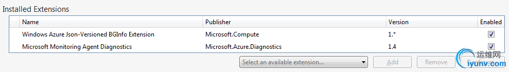

  因此,将本机2.8版本全部卸载,安装2.7版本:
  https://www.microsoft.com/en-us/download/details.aspx?id=48178
  基于2.7这个版本的Azure管理工具启用虚拟机监控扩展,OK。
