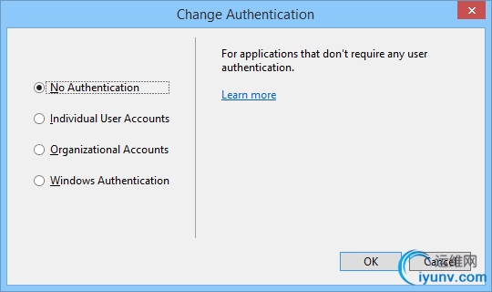

  •   In the New ASP.NET Project dialog, and select MVC, and click Change Authentication.
  •   Select No Authentication in the Change Authentication dialog, and click OK.
      Note: If you select a different authentication provider for your application, a Startup.cs class will be created for you; you will not need to create your own Startup.cs class in step 10 below.

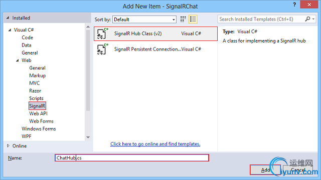

  •   Right-click the Hubs folder, click Add | New Item, select the Visual C# | Web | SignalR node in the Installed pane, select SignalR Hub Class (v2) from the center pane, and create a new hub named ChatHub.cs. You will use this class as a SignalR server hub that sends messages to all clients.
  •   Replace the code in the ChatHub class with the following code.using System;
