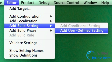

Using clang-omp with Xcode
  • Website for this extension: http://clang-omp.github.io/
  • Install clang-omp using homebrew:
  • brew install clang-omp
  • Create a new Xcode project.
  • Under click 'the name of the project' —> Build Settings
    • Editor --> Add Build Setting --> Add User-Defined Setting (Press ‘delete’ on the keyboard to delete the user-defined setting when you do not want it)
      • set the setting name as CC
      • set its value as /usr/local/bin/clang-omp
    • Add -fopenmp to Other C Flags
    • Add /usr/local/include to Header Search Paths
    • Set Enable Modules (C and Objective-C) to No.
