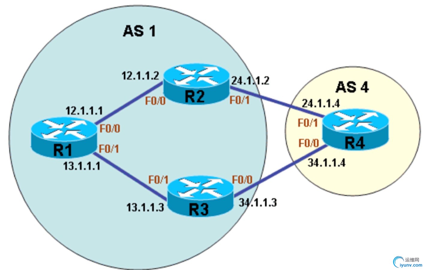

  31.BGP实验1
R1:
interface Loopback0
ip address 1.1.1.1 255.255.255.255
interface FastEthernet0/0
ip address 12.1.1.1 255.255.255.0
interface FastEthernet0/1
ip address 13.1.1.1 255.255.255.0
router ospf 3
router-id 1.1.1.1
log-adjacency-changes
network 1.1.1.1 0.0.0.0 area 0
network 12.1.1.0 0.0.0.255 area 0
network 13.1.1.0 0.0.0.255 area 0
router bgp 1
no synchronization
bgp router-id 1.1.1.1
bgp log-neighbor-changes
neighbor 2.2.2.2 remote-as 1
neighbor 2.2.2.2 update-source Loopback0
neighbor 3.3.3.3 remote-as 1
neighbor 3.3.3.3 update-source Loopback0
no auto-summary
R2:
interface Loopback0
ip address 2.2.2.2 255.255.255.255
ip address 12.1.1.2 255.255.255.0
ip address 24.1.1.2 255.255.255.0
router ospf 3
router-id 2.2.2.2
network 2.2.2.2 0.0.0.0 area 0
network 24.1.1.0 0.0.0.255 area 0
router bgp 1
no synchronization
bgp router-id 2.2.2.2
neighbor 1.1.1.1 remote-as 1
neighbor 1.1.1.1 update-source Loopback0
neighbor 4.4.4.4 remote-as 4
neighbor 4.4.4.4 ebgp-multihop 255
neighbor 4.4.4.4 update-source Loopback0
no auto-summary
R3:
interface Loopback0
ip address 3.3.3.3 255.255.255.255
ip address 34.1.1.3 255.255.255.0
ip address 13.1.1.3 255.255.255.0
router ospf 3
router-id 3.3.3.3
network 3.3.3.3 0.0.0.0 area 0
network 34.1.1.0 0.0.0.255 area 0
router bgp 1
no synchronization
bgp router-id 3.3.3.3
no auto-summary
R4:
interface Loopback0
ip address 4.4.4.4 255.255.255.255
ip address 34.1.1.4 255.255.255.0
ip address 24.1.1.4 255.255.255.0
router ospf 3
router-id 4.4.4.4
network 4.4.4.4 0.0.0.0 area 0
router bgp 4
no synchronization
bgp router-id 4.4.4.4
neighbor 2.2.2.2 ebgp-multihop 255
neighbor 3.3.3.3 ebgp-multihop 255
no auto-summary
