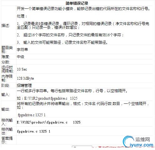

  题2
#include <iostream>
#include <string>
#include <vector>
using namespace std;
struct Log
string name;
int row;
int times;
string getname(string &addrandname)
string name;
int N=addrandname.size(),num=1;
while(addrandname[N-num]!='\\'&&num!=17)//跳出循环条件,遇到\或第17次循环
num++;
name=addrandname.substr(N-num+1,num-1);
return name;
void savelog(vector<Log> &vec_log, Log log)
int N=vec_log.size(),flag=0;
for(int i=0;i<N;i++)
if(vec_log.name==log.name&&vec_log.row==log.row)
vec_log.times++;
flag=1;
if(flag==0)
vec_log.push_back(log);
void prin(vector<Log> vec_log)
int N=vec_log.size();
cout<<vec_log.name<<" "<<vec_log.row<<" "<<vec_log.times<<endl;
int main()
string addrandname;
int row;
cin.sync();//清除输入缓冲区中的数据流
cin.clear();// 将流中的所有状态值都重设为有效值
vector<Log> vec_log;
Log log;
while(cin>>addrandname>>row)
log.name=getname(addrandname);
log.row=row;
log.times=1;
savelog(vec_log,log);
prin(vec_log);
