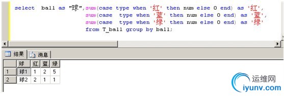

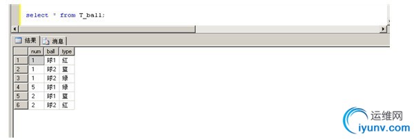

行转列(case when用法)
  数据库原来的数据:如下图
  修改后的数据:
  select  ball as "球",sum(case type when '红' then num else 0 end) as '红',
  sum(case  type when '蓝' then num else 0 end) as '蓝',
  sum(case  type when '绿' then num else 0 end) as '绿'
  from T_ball group by ball;
  如下图
