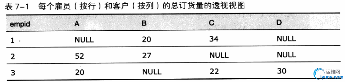

  不过,假设现在要求要按下表所示的的格式来生成输出结果:
  这时,我们就需要进行透视转换了!
  (3)使用标准SQL进行透视转换
  Step1.分组:GROUP BY empid;
  Step2.扩展:CASE WHEN custid='A' THEN qty END;
  Step3.聚合:SUM(CASE WHEN custid='A' THEN qty END);
--1.1标准SQL透视转换
select empid,
SUM(case when custid='A' then qty end) as A,
SUM(case when custid='B' then qty end) as B,
SUM(case when custid='C' then qty end) as C,
SUM(case when custid='D' then qty end) as D
from dbo.Orders
group by empid;
  执行结果如下图所示:
