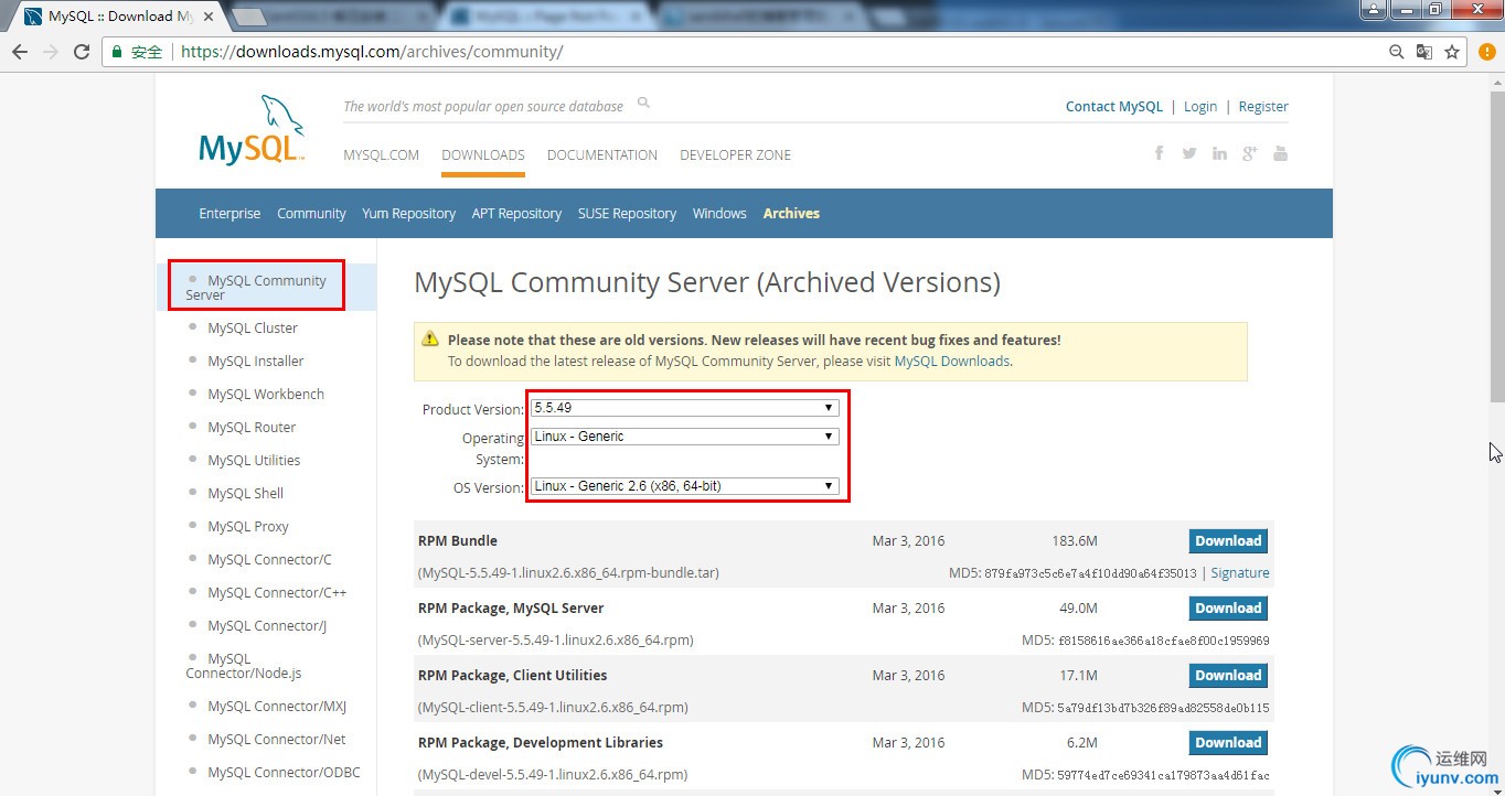

myseql 二进制包下载地址:
https://downloads.mysql.com/archives/community/
http://dev.mysql.com/get/Downloads/MySQL-5.5/mysql-5.5.49-linux2.6-x86_64.tar.gz
