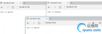

测试高可用
1、编辑nginx主页
[iyunv@juispan ~]# echo "this is master" > /usr/share/nginx/html/index.html
[iyunv@localhost ~]# echo "this is backup" > /usr/share/nginx/html/index.html
2、客户端测试
