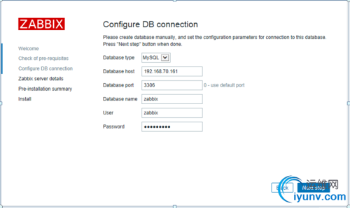

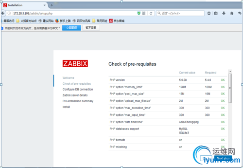

2.3 配置zabbix web页面(server端)
vi /etc/httpd/conf.d/zabbix.conf
# Zabbix monitoring systemphp web frontend
#Alias/zabbix/usr/share/zabbix
Alias /zabbix/var/www/zabbix/php
<Directory "/var/www/zabbix/php">

然后访问http://192.168.70.161/zabbix/setup.php这个地址,如下进行安装:
完成后即可登录:zabbix默认的用户名和密码是Admin/zabbix

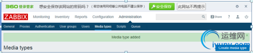

2.4 配置邮件告警yum install mailx –y
mv /etc/mail.rc/etc/mail.rc.bak
vi /etc/mail.rc
set from="xkeqiang@pbcc.org.cn"
set smtp=11.201.249.14
set amtp-auth-user=xkeqiang
set smtp-auth-password=smgnews
set smtp-auth=login
vi/usr/local/zabbix-server/share/zabbix/alertscripts/mailx.sh
#!/bin/sh
echo "$3">/tmp/1.txt
dos2unix /tmp/1.txt
mail -s "$2"$1</tmp/1.txt
echo"#############################`date`##############################">>/tmp/zabbix-mail.txt
echo "mail to $1">>/tmp/zabbix-mail.txt
echo "$2">>/tmp/zabbix-mail.txt
echo "$3">>/tmp/zabbix-mail.txt
chmod +x/usr/local/zabbix-server/share/zabbix/alertscripts/mailx.sh

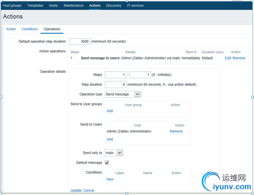

告警信息:
告警主机:{HOSY.NAME}
告警IP:{HOST.IP}
告警时间:{EVENT.DATE}  {EVENT.TIME}
告警等级:{TRIGGER.SEVERITY}
告警名称:{TRIGGER.NAME}
目前状态:{TRIGGER.STATUS}
告警URL:{TRIGGER.URL}
时间ID:{EVENT.ID}
告警信息: {ITEM.NAME1}({HOST.NAME1}:{ITEM.KEY1}): {ITEM.VALUE1}
告警恢复信息:
告警主机:{HOST.NAME}
告警IP    :{HOST.IP}
恢复时间:{EVENT.DATE}  {EVENT.RECOVERY.TIME}
告警名称:{TRIGGER.NAME}
告警URL:{TRIGGER.URL}
事件ID    :{EVENT.ID}
告警详细信息如下:
