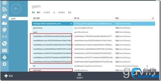

我们上一篇介绍了windows azure 联合身份验证服务的配置,实现本地的Active Directory和windows azure Active Directory实现联合认证,完成SSO-单点登陆。其中有一个过程是需要通过dirsync工具将本地的Active Directory 信息同步到windows azure Active Directory上,同步后,我们发现默认是将本地所有的用户组信息同步到windows azure Active Directory,这样的同步结果对于管理员来说是很不方便的,为什么呢,因为如果本地有上千甚至过万的用户,这些用户信息都同步到windows azure Active Directory上的话维护起来不方便,那怎么实现将指定的本地Active Directory信息同步到windows azure Active Directory下呢,答案是当然,就是配置windows azure Active Directory目录同步筛选,我们通过配置筛选将指定的用户、OU或者Domain同步到windows azure Active Directory下,同步的默认配置,随后又配置了筛选,则筛选掉的对象将不再同步到云。因此,目录同步过程将会删除云中前面已同步但随后从同步中筛选掉的所有对象。如果由于筛选出错而无意中删除了对象,你可以在云中重新创建这些对象,方法是删除筛选配置,然后重新同步目录。还有就是默认同步时长为3小时。如果需要立即生效的话,我们需要通过windows powershell进行强制目录同步操作,具体见下:http://technet.microsoft.com/zh-cn/library/jj710171.aspx
我们得知,默认是将本地的所有信息都是同步到windows azure Active Directory下的。

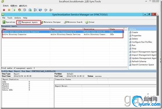

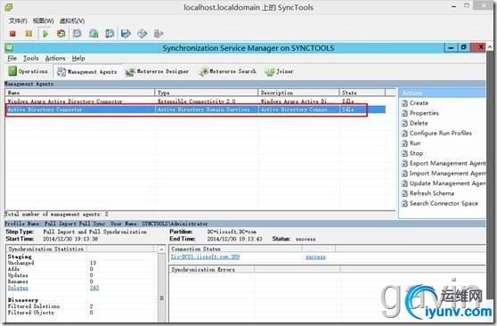

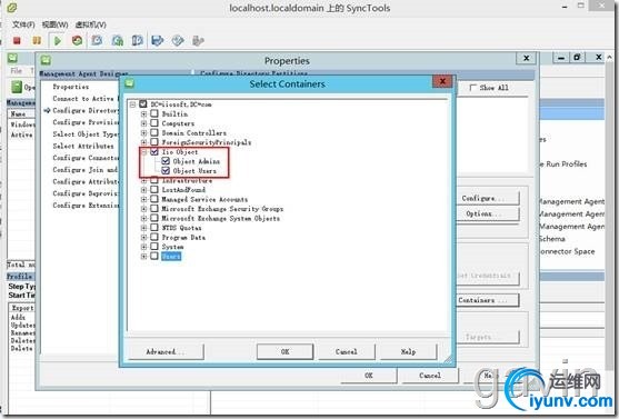

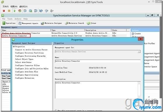

In Identity Manager, click Management Agents, and then double-click Active Directory Connector.

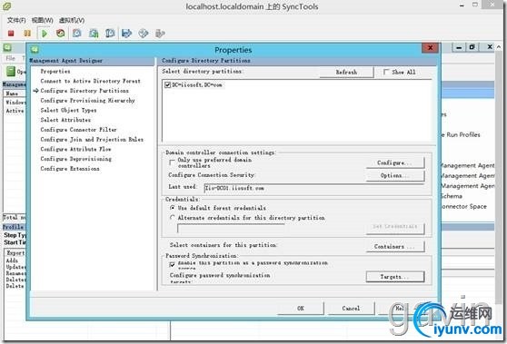

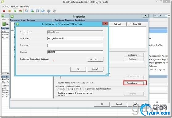

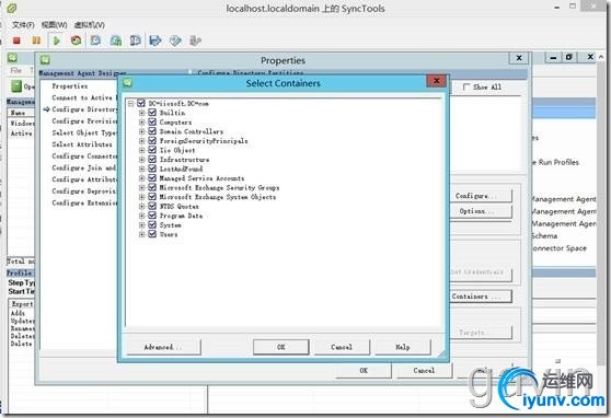

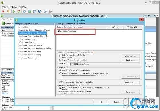

Click Configure Directory Partitions, and then click Containers
Note:When presented with the credentials dialog box, the MSOL_AD_Sync account will be displayed. This account is using a randomly generated password, so administrators will not know the password. When performing this filtering operation, you should enter an account which has access to the Active Directory forest. The account used here should be an Enterprise Admin. The Enterprise Admin account can view the entire forest and perform the filtering within any domain within the forest. Using a Domain Admin will limit the scope of what the Directory Synchronization tool can view and may not be viable when needing to expand the filter into other domains.
所以我们再次输入域管理员账户及密码验证
In the Select Containers dialog box, clear the OUs that you don’t want to synch with the cloud directory, and then click OK. Click OK on the SourceAD Propertiespage
Click ok

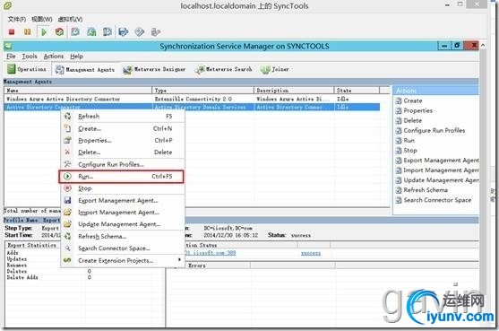

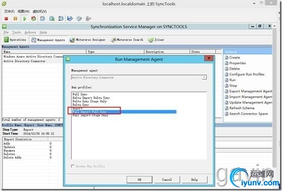

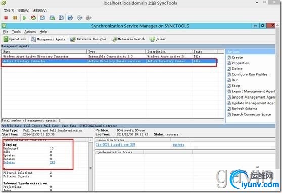

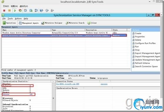

Perform a full sync: on the Management Agent tab, right-click Active Directory Connector, click Run, click Full Import Full Sync, and then click OK.
开始sync
同步完成:

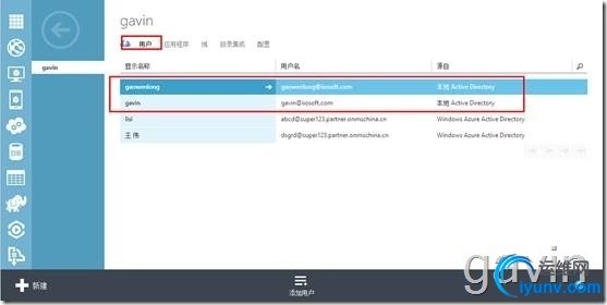

同步后我们查看azure的用户状

Click Configure Directory Partitions, and then select the domains that you want to synchronize. To filter a domain out of the synchronization process, clear the domain’s check box.

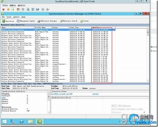

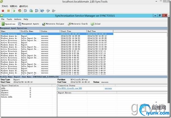

4.同步时间
我们最后通过log确认,dirsync默认的同步时间为3小时一次。

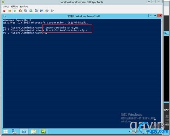

如果我们在修改后的某个属性的话,需要理解生效的话,我们可以通过powershell进行强制同步。
5.使用windows powershell强制执行目录同步
我们需要在运行同步目录工具的计算机上,启动powshell,输入import-module dirsync 然后回车确认。

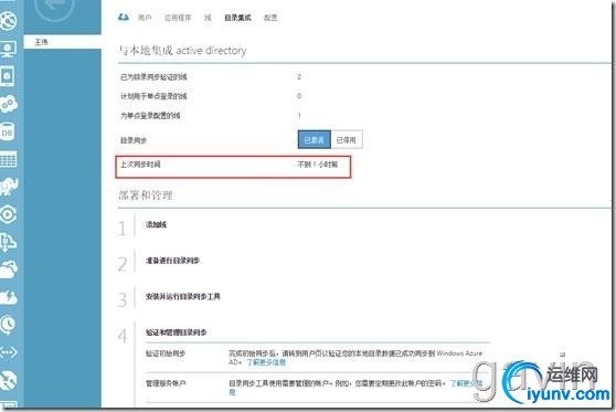

然后我们通过start-onlinecoexistencesync来进行强制同步
执行后,我们可以在windows azure portal页面上看见同步时间

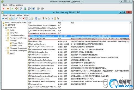

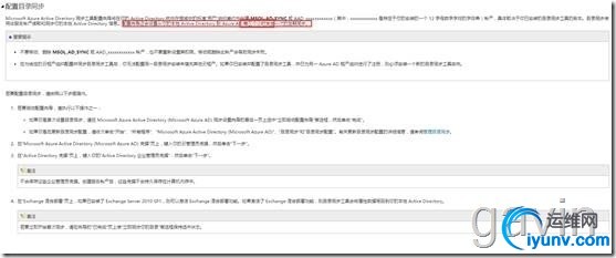

我们最后再强调一个问题,在配置目录同步时,系统会在本地的Active Directorty林中创建一个同步用户组,用该服务器账户读取和同步你本地的Active directory信息。
在为给订的云租户组织配置并同步该工具后,你无法配置同一目录同步安装来填充其他云租户。
