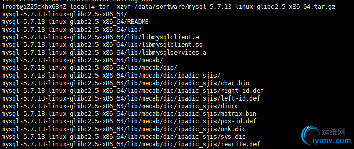

  # tar -xzvf /data/software/mysql-5.7.13-linux-glibc2.5-x86_64.tar.gz
  #ls

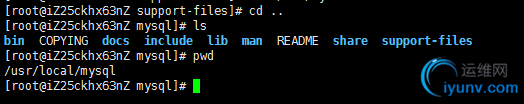

  2、改变目录属有者
  #cd /usr/local/mysql
  #pwd
  #chown -R mysql .
  #chgrp -R mysql .

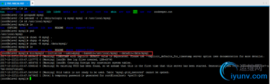

  #bin/mysqld --initialize --user=mysql --basedir=/usr/local/mysql --datadir=/data/mysql
  此处需要注意记录生成的临时密码,如上文:*gre1Y::Q<A-

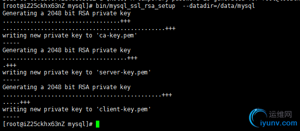

  #bin/mysql_ssl_rsa_setup --datadir=/data/mysql

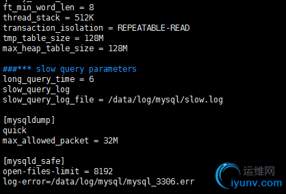

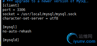

  #vim /etc/my.cnf
  修改以下内容:
  # For advice on how to change settings please see
# http://dev.mysql.com/doc/refman/5.7/en/server-configuration-defaults.html
# *** DO NOT EDIT THIS FILE. It's a template which will be copied to the
# *** default location during install, and will be replaced if you
# *** upgrade to a newer version of MySQL.
[mysqld]
skip-name-resolve
lower_case_table_names=1
# max_connections = 2000
# Remove leading # and set to the amount of RAM for the most important data
# cache in MySQL. Start at 70% of total RAM for dedicated server, else 10%.
# innodb_buffer_pool_size = 128M
# Remove leading # to turn on a very important data integrity option: logging
# changes to the binary log between backups.
# log_bin
# These are commonly set, remove the # and set as required.
# basedir = .....
# datadir = /var/lib/mysql/
# port = .....
# server_id = .....
# socket = .....
# Remove leading # to set options mainly useful for reporting servers.
# The server defaults are faster for transactions and fast SELECTs.
# Adjust sizes as needed, experiment to find the optimal values.
# join_buffer_size = 128M
# sort_buffer_size = 2M
# read_rnd_buffer_size = 2M
log_error = /data/log/mysql/error.log
#err-log = /var/log/mysqld.log
#pid-file = /var/lib/mysql/localhost.localdomain.pid
sql_mode=NO_ENGINE_SUBSTITUTION,STRICT_TRANS_TABLES

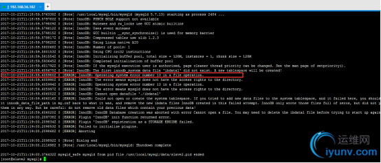

  5、启动MySQL
  #bin/mysqld_safe --user=mysql &

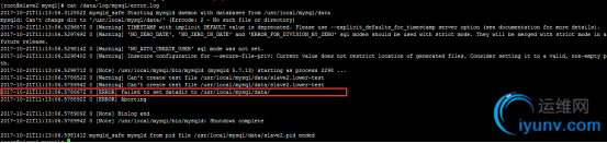

  异常:
  查看日志:cat /data/log/mysql/error.log
  再次执行:#bin/mysqld_safe --user=mysql &
  日志还是报错,如下
  解决方案参照:http://blog.csdn.net/chenjiayi_yun/article/details/16920967
  赋予/data 权限:chmod -R 777 /data
  但是重启 查看日志还是报错
  删除/data/mysql 中的 ibdata1 ib_logfile0 ib_logfile1
  如果日志还报错,那就不采用这种安全模式启动,直接启动mysql

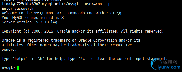

  bin/mysql --user=root -p
  --输入第6步生成的临时密码

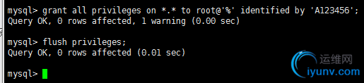

  mysql>set password=password('123456');
  mysql>grant all privileges on *.* to root@'%' identified by '123456';
  mysql>flush privileges;
  mysql>use mysql;
  mysql>select host,user from user;

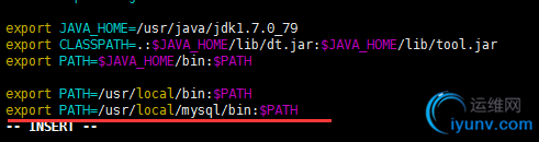

  6、添加系统路径
  #vim /etc/profile
  添加:
  export PATH=/usr/local/mysql/bin:$PATH
  如下:
  #source /etc/profile
