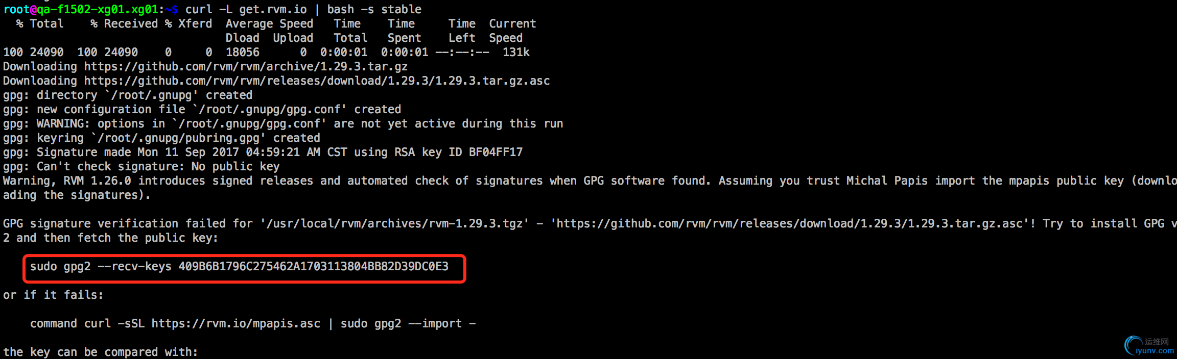

  安装rvm,我不知道这是个什么东西,但是感觉像是Ruby的一个包管理器。
# curl -L get.rvm.io | bash -s stable
  WTF,又出问题了
  气急败坏的照着他说的做
# gpg2 --recv-keys 409B6B1796C275462A1703113804BB82D39DC0E3
gpg: keyring `/root/.gnupg/secring.gpg' created
gpg: requesting key D39DC0E3 from hkp server keys.gnupg.net
gpg: /root/.gnupg/trustdb.gpg: trustdb created
gpg: key D39DC0E3: public key "Michal Papis (RVM signing) <mpapis@gmail.com>" imported
gpg: no ultimately trusted keys found
gpg: Total number processed: 1
gpg:               imported: 1  (RSA: 1)
  然后重新下载rvm安装,成功了。
