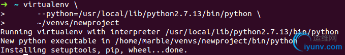

  • Start a new project:
    ➜ mkdir ~/venvs
    ➜ cd ~/venvs
    ➜ virtualenv --python=/usr/local/lib/python2.7.13/bin/python newproject
      Should look like:
