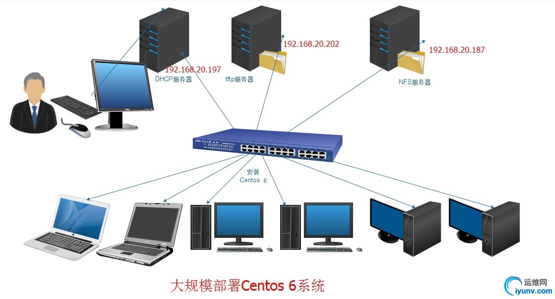

大规模部署安装Centos 6时,所用的网络架构图
由上图知,得先在服务器上安装好DHCP服务和tftp服务和NFS服务,在安装Centos 6是我们把这些服务都分开来,安装Centos 7是把这些服务都做到一个主机上来安装。
DHCP服务给网络安装的主机提供ip地址,主机获得ip地址后,需要下载系统安装需要的文件(内核,根文件系统镜像,bootloader等)到tftp服务器上下载,安装需要的应用程序在http服务器上,ks文件也在http服务器上,让系统安装通过读取ks文件自动完成安装。
对于安装过程中有问题的可以互相交流,本人折腾了好几天了

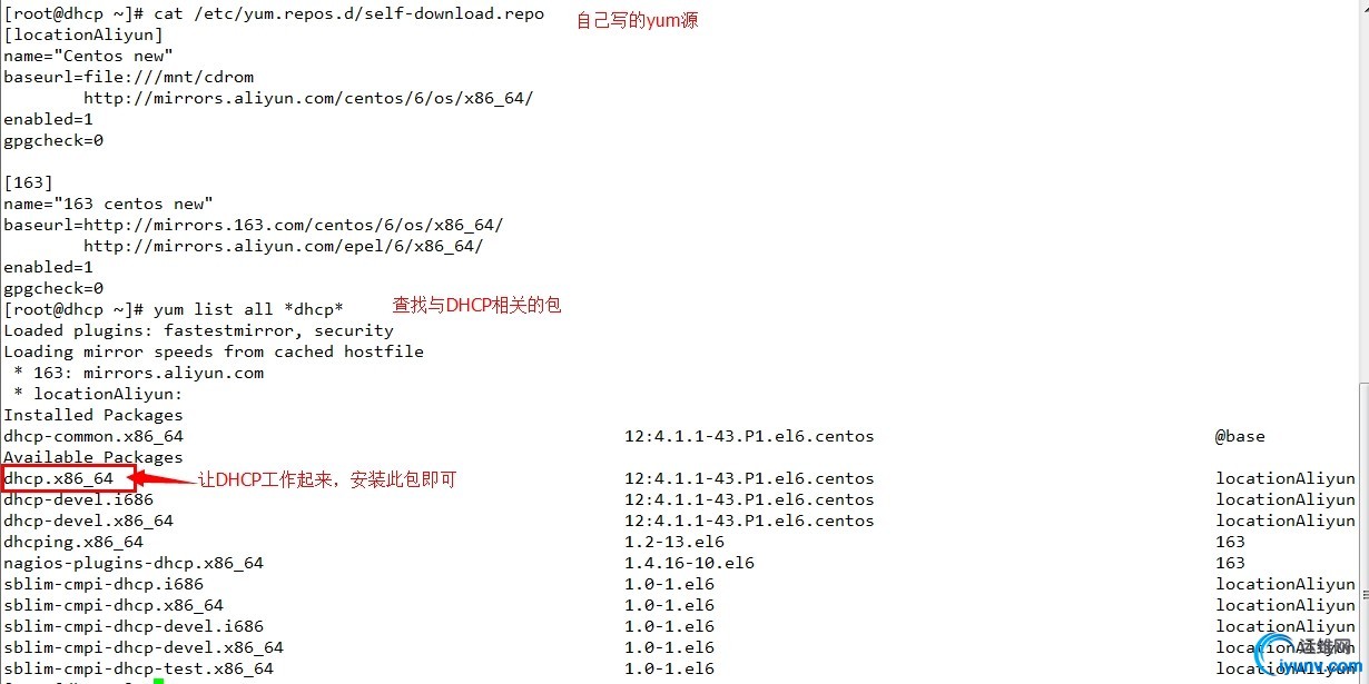

    安装DHCP:
    [iyunv@dhcp ~]# yum install dhcp -y
    查看安装DHCP后,生成哪些文件:
    [iyunv@dhcp ~]# rpm -ql dhcp | less   一般文件比较多时,可以使用less分页来查看

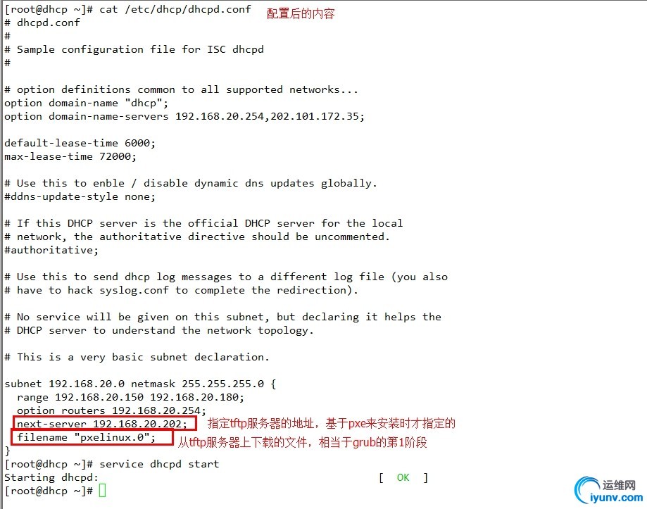

    查看修改dhcpd.conf
    [iyunv@dhcp ~]# cat /etc/dhcp/dhcpd.conf
    # dhcpd.conf
    # Sample configuration file for ISC dhcpd
    # option definitions common to all supported networks...
    option domain-name "example.org";域名,改为主机名 dhcp
    option domain-name-servers ns1.example.org, ns2.example.org;  名称服务器地址  设为DNS服务器地址 202.101.172.35;
    default-lease-time 600;  默认租用时长可以根据需要做设定单位是s(秒)
    max-lease-time 7200;  最大租用时长
    # Use this to enble / disable dynamic dns updates globally.
    #ddns-update-style none;
    # If this DHCP server is the official DHCP server for the local
    # network, the authoritative directive should be uncommented.
    #authoritative;
    # Use this to send dhcp log messages to a different log file (you also
    # have to hack syslog.conf to complete the redirection).
    log-facility local7;  日志设施
    # No service will be given on this subnet, but declaring it helps the
    # DHCP server to understand the network topology.
    subnet 10.152.187.0 netmask 255.255.255.0 {  IP地址分配设定,把这里删除
    # This is a very basic subnet declaration.
            所在的网络           所在的掩码
    subnet 192.168.20.0 netmask 255.255.255.0 {
      range 192.168.20.150 192.168.20.180;动态配置ip的范围,中间使用空格隔开
      option routers 192.168.20.254; 指定做转发的地址(路由器的地址)【此处用网关】

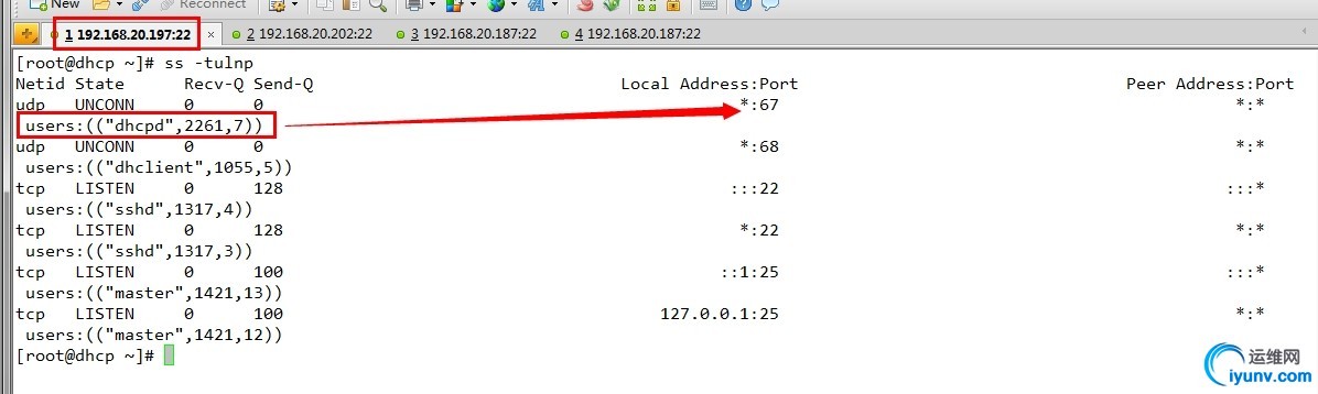

    DHCP服务启动成功
    [iyunv@dhcp ~]# ss -ulnp
    State       Recv-Q Send-Q                                   Local          Address:Port                                     Peer Address:Port
    UNCONN      0      0                                                      *:67                                                  *:*      users:(("dhcpd",2261,7))
    UNCONN      0      0                                                    *:68                                                  *:*      users:(("dhclient",1055,5))
   工作在udp的67端口

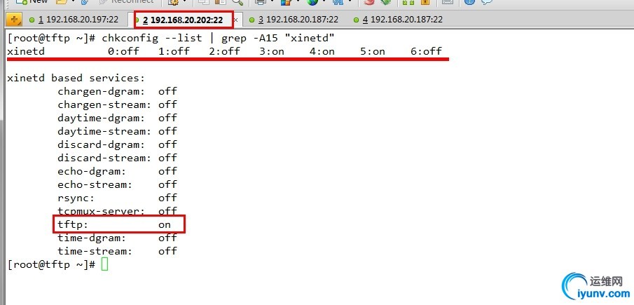

    查看xinetd启动级别
    [iyunv@tftp ~]# chkconfig --list | grep -A13 "xinetd"
    xinetd             0:off    1:off    2:off    3:on    4:on    5:on    6:off
    xinetd based services:  基于xinetd的服务
        chargen-dgram:     off
        chargen-stream:    off
        daytime-dgram:     off
        daytime-stream:    off
        discard-dgram:     off
        discard-stream:    off
        echo-dgram:        off
        echo-stream:       off
        rsync:             off
        tcpmux-server:     off
        tftp:              off
        time-dgram:        off
        time-stream:       off
    启动xinetd,和上面显示的3,4,5级别on(此时的生效级别是要重启后才会在在对应的级别启动)没关系,需要手动启动xinetd
    [iyunv@tftp ~]# service xinetd start
    Starting xinetd:                                           [  OK  ]
    启动基于xinetd的服务
    方法1:
    [iyunv@tftp ~]# chkconfig tftp on
    方法2:可以修改tftp的配置文件/etc/xinetd.d/tftp使disable = no,后再重启xinetd也可
    #service xinetd restart  这两种方法都可以
        chargen-dgram:     off
        chargen-stream:    off
        daytime-dgram:     off
        daytime-stream:    off
        discard-dgram:     off
        discard-stream:    off
        echo-dgram:        off
        echo-stream:       off
        rsync:             off
        tcpmux-server:     off
        tftp:              on  已经启动了
        time-dgram:        off
        time-stream:       off

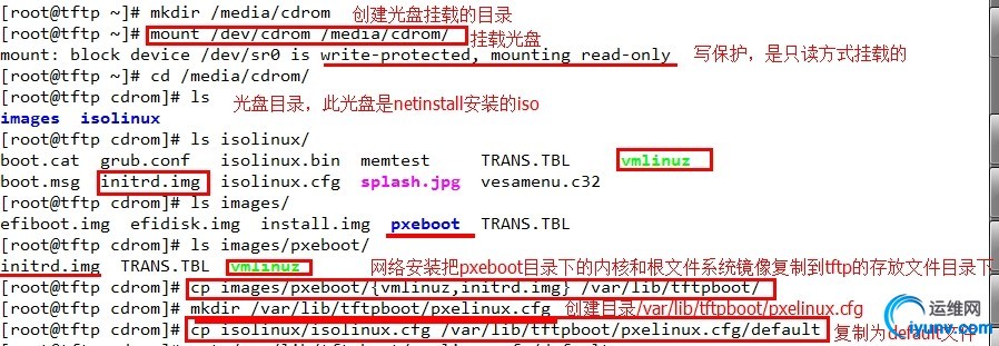

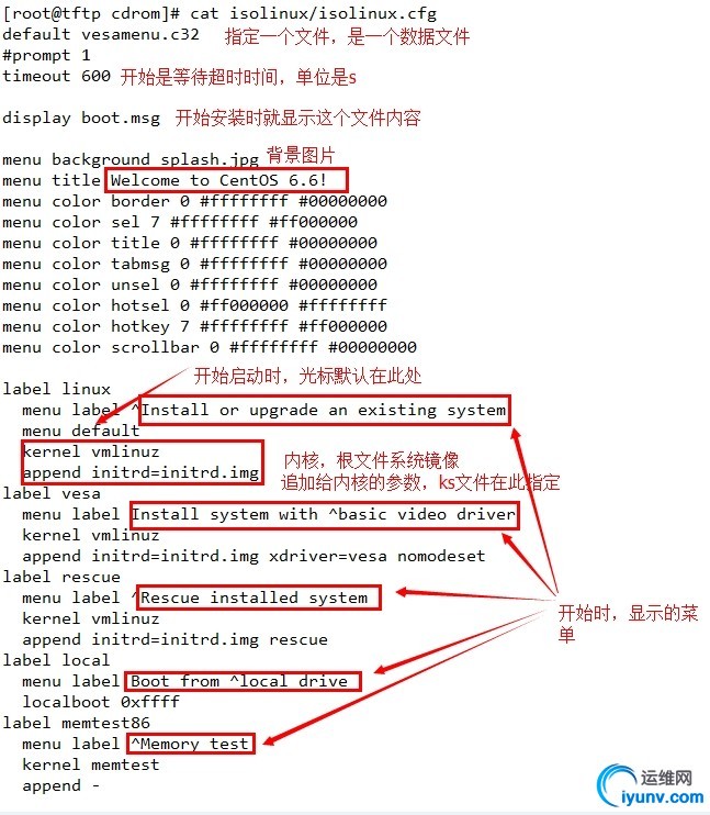

   获取内核,根文件系统镜像,bootloader等文件,我们可以通过挂载centos光盘来实现,也可以直接到官网下载,此处以光盘获取为例。
  安装syslinux,得到pxelinux.0,把pxelinux.0复制到/var/lib/tftpboot目录下
   [iyunv@tftp cdrom]# yum install syslinux
   [iyunv@tftp cdrom]# cp /usr/share/syslinux/pxelinux.0 /var/lib/tftpboot/

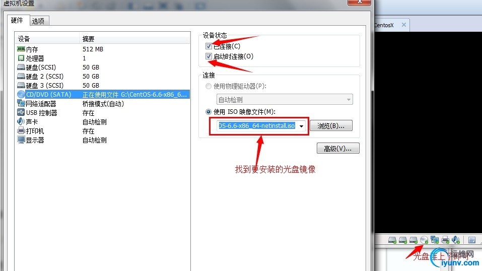

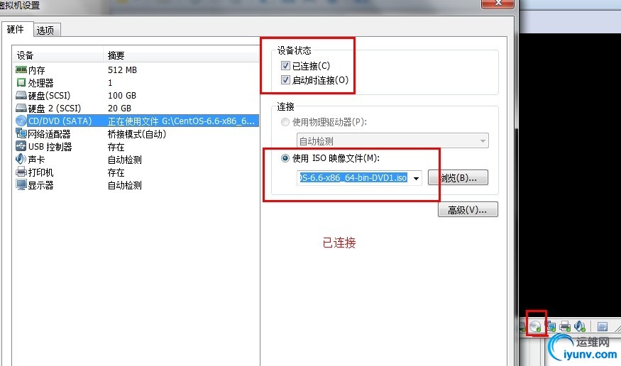

    光盘为CentOS-6.6-x86_64-netinstall.iso

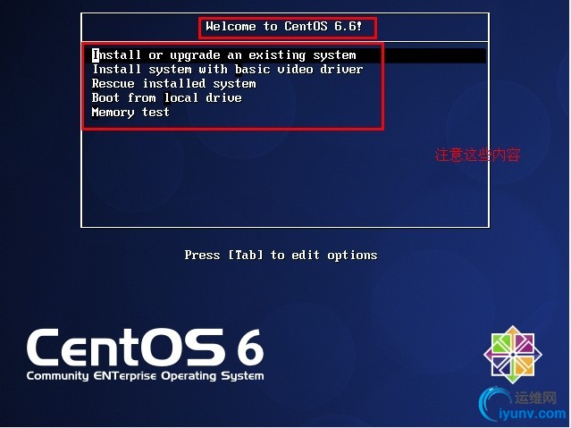

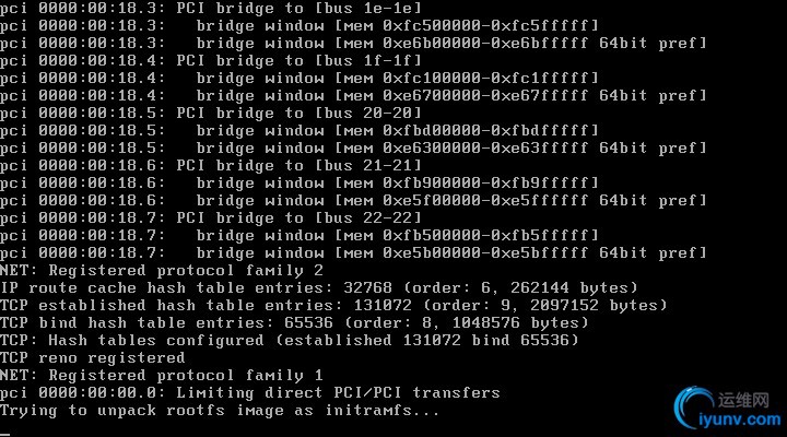

  新建一个虚拟机CentosX,加载一个光盘CentOS-6.6-x86_64-netinstall.iso,启动虚拟机如下
   [iyunv@tftp cdrom]# ls isolinux/
    boot.cat  grub.conf   isolinux.bin  memtest     TRANS.TBL     vmlinuz
    boot.msg  initrd.img  isolinux.cfg  splash.jpg  vesamenu.c32
   [iyunv@tftp cdrom]# ls /var/lib/tftpboot/
    initrd.img  pxelinux.0  pxelinux.cfg  vmlinuz
   [iyunv@tftp cdrom]# cp isolinux/{boot.msg,splash.jpg,vesamenu.c32} /var/lib/tftpboot/

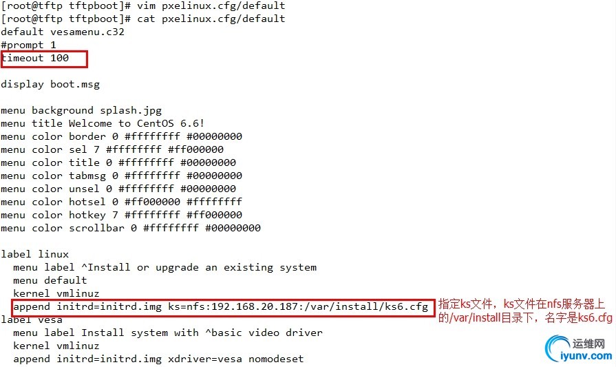

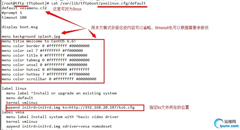

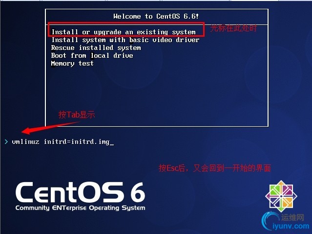

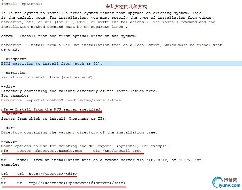

     指定使用的kickstart文件及其位置
          ks=cdrom:/path/to/ksfile
          ks=http://server/path/to/ksfile
          ks=ftp://username:password@server/path/to/ksfile
          ks=nfs:server.mydomain.com:/directory/ks.cfg

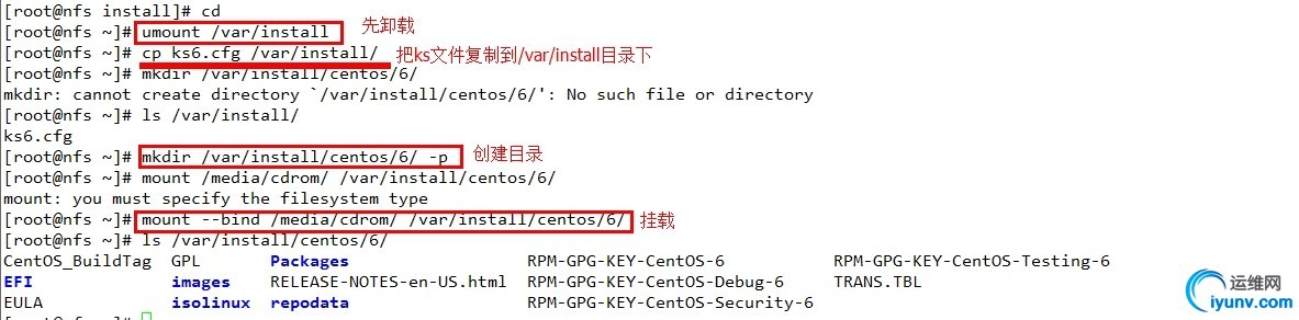

    新建/var/install目录
    [iyunv@nfs ~]# mkdir /var/install

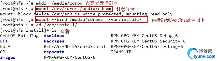

    把光盘挂载上

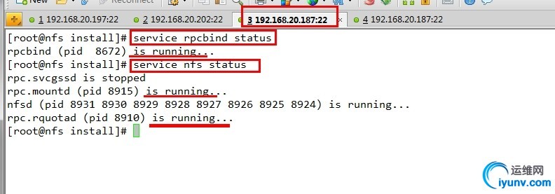

wKiom1TBjznzRNjeAAI_PRtZ5KY071.jpg      查看这些服务是否都启动

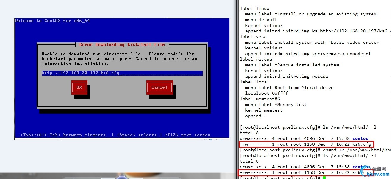

     ks文件的书写可以查看官方文档Red_Hat_Enterprise_Linux-6-Installation_Guide-en-US.pdf,里面详细介绍了每一项的使用。

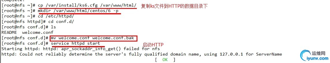

     安装http,[iyunv@nfs ~]# yum install httpd

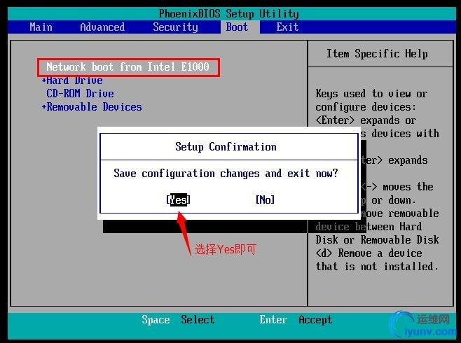

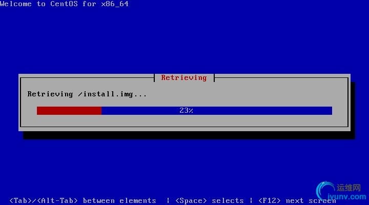

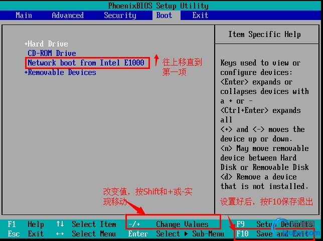

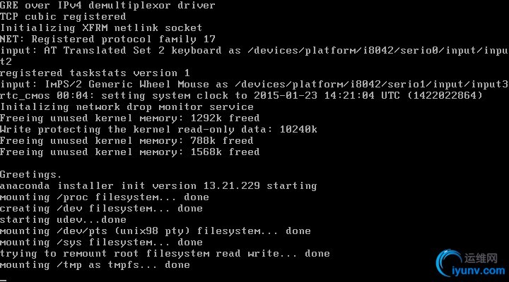

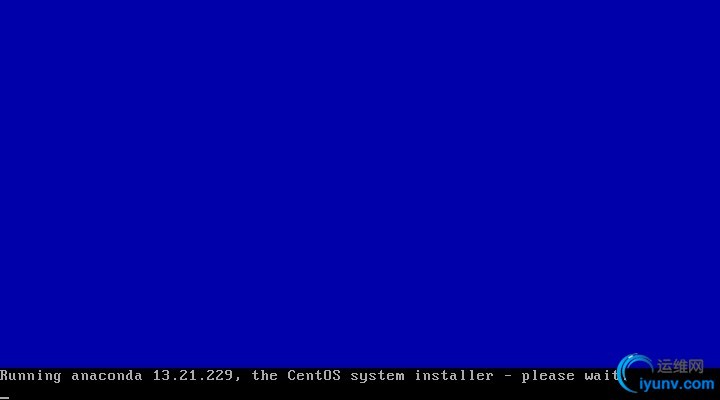

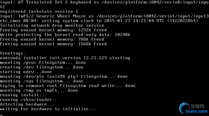

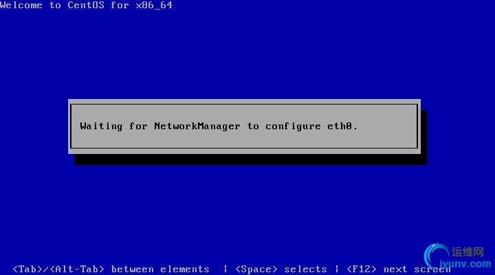

在基于网络的无人职守部署Centos系统使用PXE技术实现远程下载和安装,要使用网络安装首先需要设置BIOS通过网络方式启动。开机的时候设置BIOS:

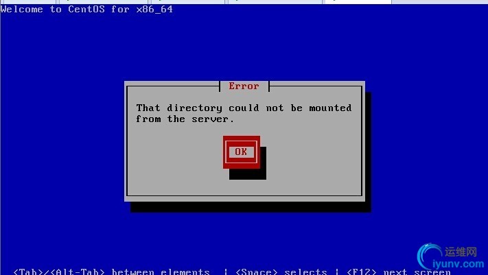

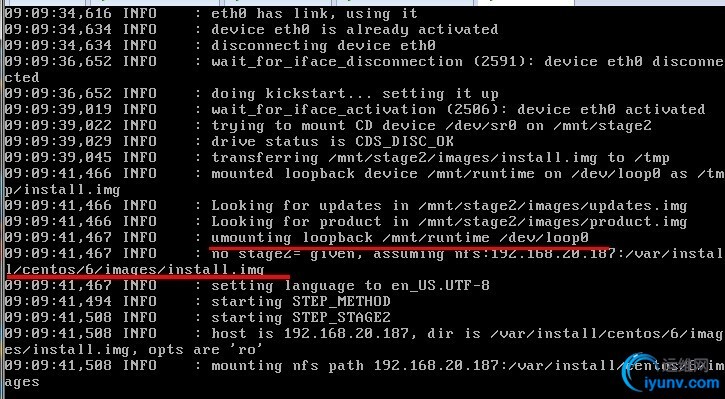

使用nfs安装的错误提示

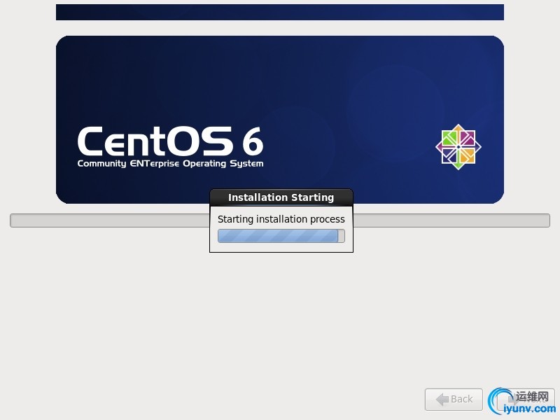

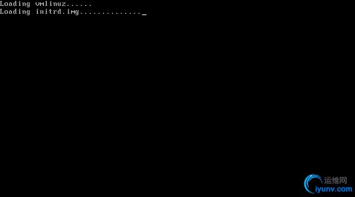

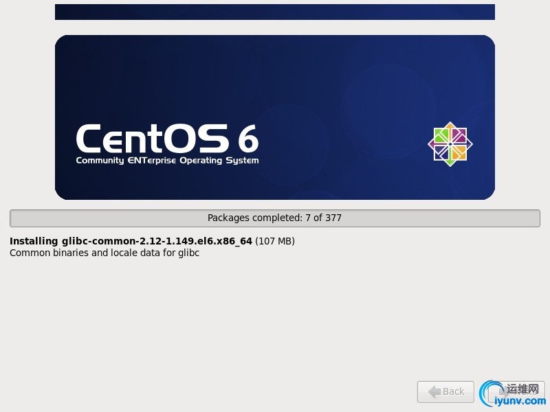

使用HTTP正常安装过程显示

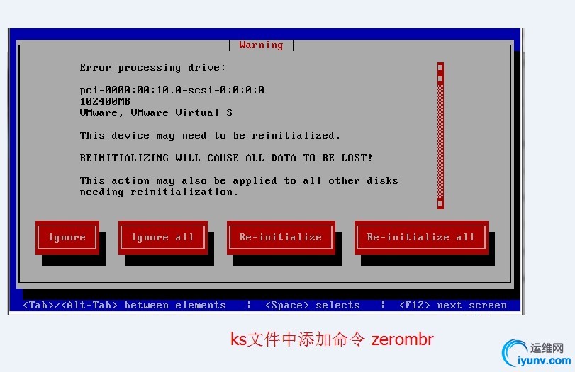

安装错误的几种提示:
所有资源均系网友上传或者通过网络收集,我们仅提供一个展示、介绍、观摩学习的平台,我们不对其承担任何法律责任,如涉及侵犯版权等问题,请您及时通知我们,我们将立即处理,联系人Email:kefu@iyunv.com,QQ:1061981298 本贴地址:https://www.yunweiku.com/thread-41457-1-1.html 上篇帖子: Centos6的NetworkManager和network,还是setup 下篇帖子: Centos6.2克隆网卡配置
