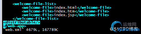

4.将<distributable/>写入Tomcat1和tomcat2的web.xml里
watermark,size_16,text_QDUxQ1RP5Y2a5a6i,color_FFFFFF,t_100,g_se,x_10,y_10,shadow_90,type_ZmFuZ3poZW5naGVpdGk=.jpg

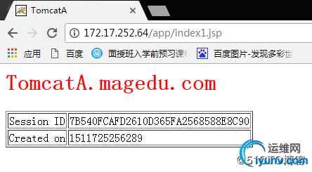

使sessionID不变
