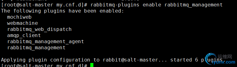

  启用web界面插件
  rabbitmq-plugins enable rabbitmq_management

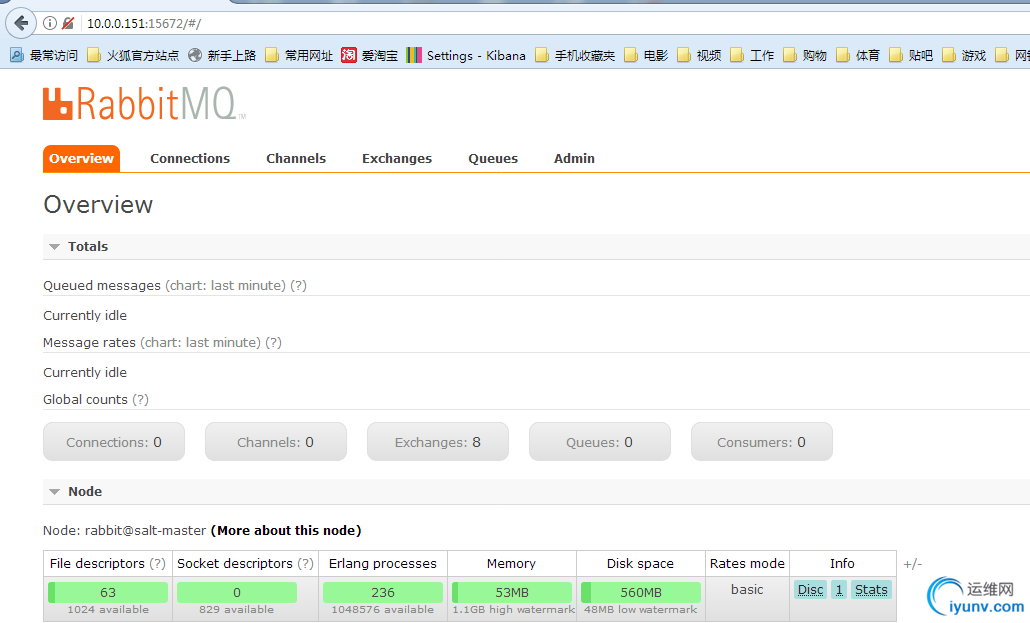

  启动15672端口
  http://10.0.0.151:15672/
  默认用户 guest guest

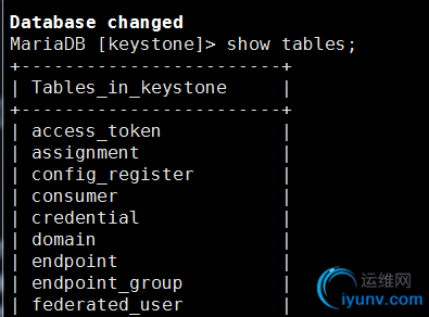

  初始化数据库
  su -s /bin/sh -c "keystone-manage db_sync" keystone
  PS:会自动读取keystone配置文件创建数据库表
  PS:同步的日志文件 /var/log/keystone/keystone.log

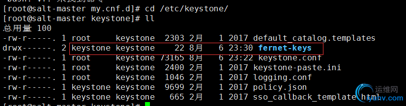

  初始化Fernet keys
keystone-manage fernet_setup --keystone-user keystone --keystone-group keystone
  在这个目录生成证书

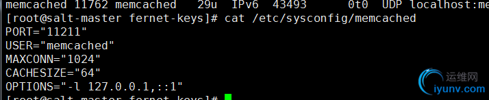

  启动memcached
  systemctl enable memcached
systemctl start memcached
