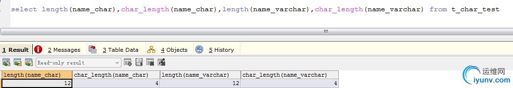

  test:
  1.建表
  create table t_char_test(
  id int(11) primary key,
  name_char char(10) ,
  name_varchar varchar(10)
  )engine=Myisam default
  insert into t_char_test(id,name_char,name_varchar) values (0,'字符类型','字符类型');
  结果集如下:
