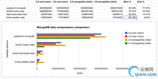

  For instance, note the different compression ratios of various datasets:
