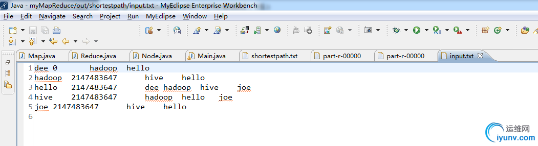

  =  Iteration:    1
  =  Input path:   out/shortestpath/input.txt
  =  Output path:  out/shortestpath/1

  output -> K[dee],V[0hadoophello]
  output -> K[hadoop],V[1dee]
  output -> K[hello],V[1dee]

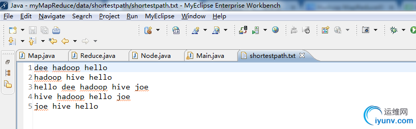

  input -> K[hadoop],V[2147483647nullhivehello]
  output -> K[hadoop],V[2147483647hivehello]
  input -> K[hello],V[2147483647nulldeehadoophivejoe]
  output -> K[hello],V[2147483647deehadoophivejoe]
  input -> K[hive],V[2147483647nullhadoophellojoe]
  output -> K[hive],V[2147483647hadoophellojoe]
  input -> K[joe],V[2147483647nullhivehello]
  output -> K[joe],V[2147483647hivehello]

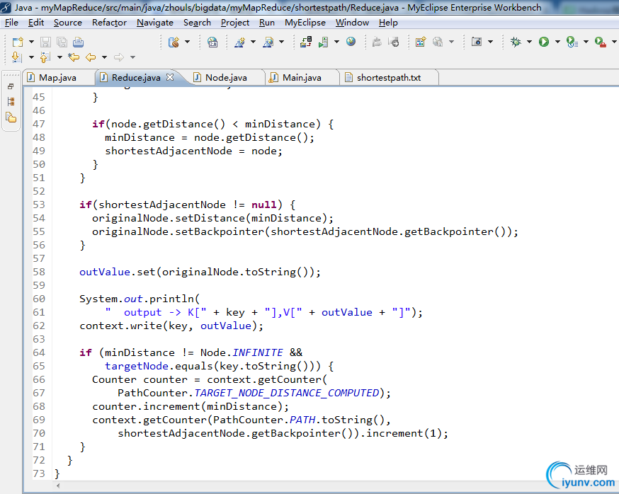

  input -> K[dee]
  input -> V[0hadoophello]
  output -> K[dee],V[0nullhadoophello]
  input -> K[hadoop]
  input -> V[2147483647hivehello]
  input -> V[1dee]
  output -> K[hadoop],V[1deehivehello]
  input -> K[hello]
  input -> V[2147483647deehadoophivejoe]
  input -> V[1dee]
  output -> K[hello],V[1deedeehadoophivejoe]
  input -> K[hive]
  input -> V[2147483647hadoophellojoe]
  output -> K[hive],V[2147483647nullhadoophellojoe]
  input -> K[joe]
  output -> K[joe],V[2147483647nullhivehello]

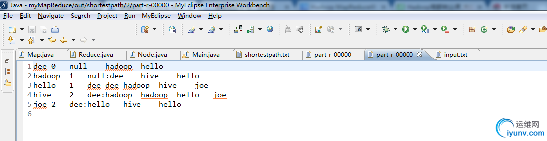

  =  Iteration:    2
  =  Input path:   out/shortestpath/1
  =  Output path:  out/shortestpath/2

  = Shortest path found, details as follows.
  = Start node:  dee
  = End node:    joe
  = Hops:        2
  = Path:        dee:hello

  public void reduce(Text key, Iterable<Text> values,
  Context context)
  throws IOException, InterruptedException {
  int minDistance = Node.INFINITE;
  System.out.println("input -> K[" + key + "]");
  Node shortestAdjacentNode = null;
  Node originalNode = null;
  for (Text textValue : values) {
  System.out.println("  input -> V[" + textValue + "]");
  Node node = Node.fromMR(textValue.toString());
  if(node.containsAdjacentNodes()) {
  // the original data
  originalNode = node;
  if(node.getDistance() < minDistance) {
  minDistance = node.getDistance();
  shortestAdjacentNode = node;
  if(shortestAdjacentNode != null) {
  originalNode.setDistance(minDistance);
  originalNode.setBackpointer(shortestAdjacentNode.getBackpointer());
  outValue.set(originalNode.toString());
  System.out.println(
  "  output -> K[" + key + "],V[" + outValue + "]");
  context.write(key, outValue);
  if (minDistance != Node.INFINITE &&
  targetNode.equals(key.toString())) {
  Counter counter = context.getCounter(
  PathCounter.TARGET_NODE_DISTANCE_COMPUTED);
  counter.increment(minDistance);
  context.getCounter(PathCounter.PATH.toString(),
  shortestAdjacentNode.getBackpointer()).increment(1);
  package zhouls.bigdata.myMapReduce.shortestpath;

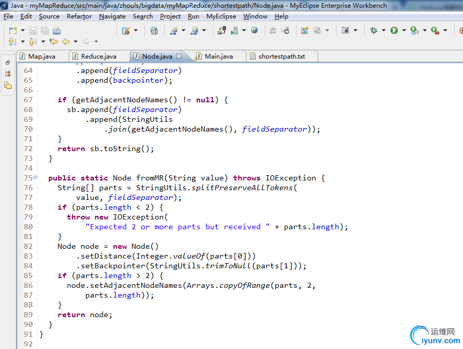

  public static Node fromMR(String value) throws IOException {
  String[] parts = StringUtils.splitPreserveAllTokens(
  value, fieldSeparator);
  if (parts.length < 2) {
  throw new IOException(
  "Expected 2 or more parts but received " + parts.length);
  Node node = new Node()
  .setDistance(Integer.valueOf(parts[0]))
  .setBackpointer(StringUtils.trimToNull(parts[1]));
  if (parts.length > 2) {
  node.setAdjacentNodeNames(Arrays.copyOfRange(parts, 2,
  parts.length));
  return node;

  String startNode = "dee";
  String targetNode = "joe";
  //    String inputFile = "hdfs://HadoopMaster:9000/shortestpath/shortestpath.txt";
  //    String outputDir = "hdfs://HadoopMaster:9000/out/shortestpath";
  String inputFile = "./data/shortestpath/shortestpath.txt";
  String outputDir = "./out/shortestpath";
  iterate(startNode, targetNode, inputFile, outputDir);

  public static void createInputFile(Path file, Path targetFile,
  String startNode)
  FileSystem fs = file.getFileSystem(conf);
  OutputStream os = fs.create(targetFile);
  LineIterator iter = org.apache.commons.io.IOUtils
  .lineIterator(fs.open(file), "UTF8");
  while (iter.hasNext()) {
  String line = iter.nextLine();
  String[] parts = StringUtils.split(line);
  int distance = Node.INFINITE;
  if (startNode.equals(parts[0])) {
  distance = 0;
  IOUtils.write(parts[0] + '\t' + String.valueOf(distance) + "\t\t",
