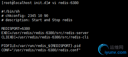

  7.在/etc/init.d文件中复制两份redis启动脚本(脚本内容见之前写的 启动redis脚本 文章)
  修改端口号和文件路径(以redis-6380为例)

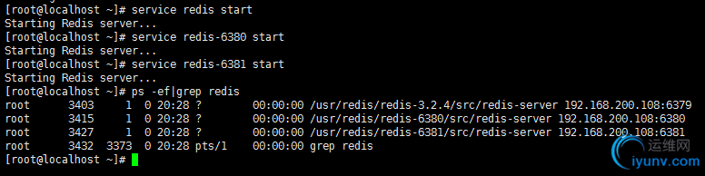

  8.启动三台redis
  启动哨兵
[iyunv@localhost ~]# ps -ef|grep redis
root
3403     1  0 20:28 ?        00:00:00 /usr/redis/redis-3.2.4/src/redis-server 192.168.200.108:6379
root
3415     1  0 20:28 ?        00:00:00 /usr/redis/redis-6380/src/redis-server 192.168.200.108:6380
root
3427     1  0 20:28 ?        00:00:00 /usr/redis/redis-6381/src/redis-server 192.168.200.108:6381
root
3432  3373  0 20:28 pts/1    00:00:00 grep redis
