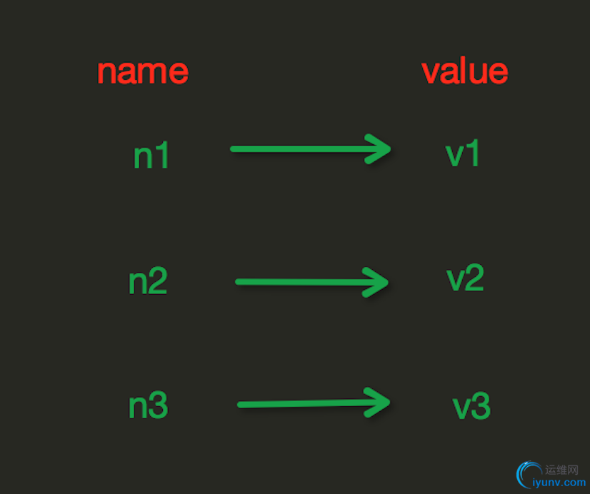

1. String操作
  redis中的String在在内存中按照一个name对应一个value来存储。如图:

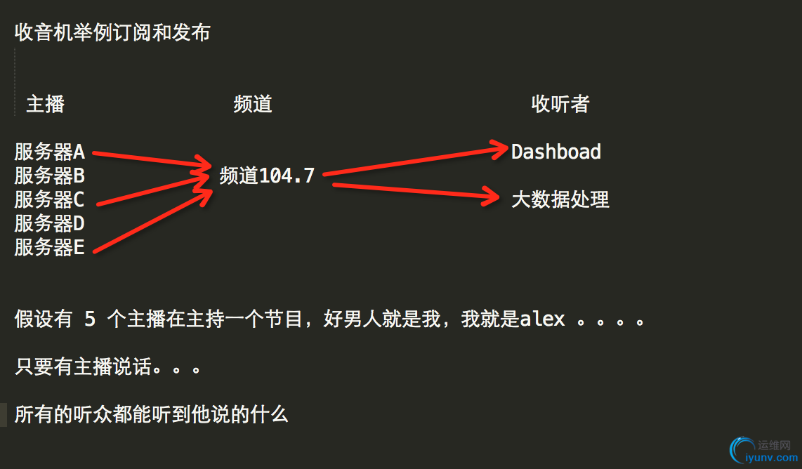

发布订阅
  发布者:服务器
  订阅者:Dashboad和数据处理
  Demo如下:
import redis
class RedisHelper:
def __init__(self):  self.
__conn = redis.Redis(host='10.211.55.4')  self.chan_sub
= 'fm104.5'  self.chan_pub
= 'fm104.5'
  def public(self, msg):
  self.__conn.publish(self.chan_pub, msg)
  return True
  def subscribe(self):
  pub = self.__conn.pubsub()
  pub.subscribe(self.chan_sub)
  pub.parse_response()
  return pub
redis helper  订阅者:
#!/usr/bin/env python
# -*- coding:utf-8 -*-
from monitor.RedisHelper import RedisHelper
obj = RedisHelper()
redis_sub = obj.subscribe()
while True:
    msg= redis_sub.parse_response()
    print msg  发布者:
obj = RedisHelper()
obj.public('hello')
  更多参见:https://github.com/andymccurdy/redis-py/
