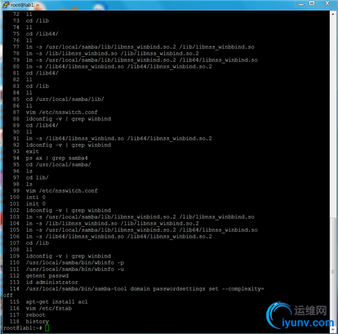

ln -s /usr/local/samba/lib/libnss_winbind.so.2 /lib/libnss_winbind.socreate your symbolic links to the appropriate libraries
38
ln -s /lib/libnss_winbind.so /lib/libnss_winbind.so.2
39
ln -s /usr/local/samba/lib/libnss_winbind.so.2 /lib64/libnss_winbind.so
40
ln -s /lib64/libnss_winbind.so /lib64/libnss_winbind.so.2
41
vim /etc/nsswitch.conf to initially resolve user and group information from /etc/passwd and /etc/group/ and then from the Windows NT server.To setup winbindd for user and group lookups plus authentication from a domain controller use something like the following setup in nsswitch.conf file ⇒ passwd: files winbind     ⇒group:  files winbind to instruct the system to use the nss winbind library when searching for users or groups(to allow user and group entries to be visible from the winbindd daemon)
42
ldconfig -v | grep winbindThe libraries needed by the winbindd  daemon will be automatically entered into the ldconfig  cache the next time your system reboots, but it is faster (and you do not need to reboot) if you do it manually.This makes libnss_winbind available to winbindd and reports the current search path that is used by the dynamic link loader. The use of the grep  filters the output of the ldconfig  command so that we may see proof that this library is indeed recognized by the dynamic link loader. confirm the library is loaded
43

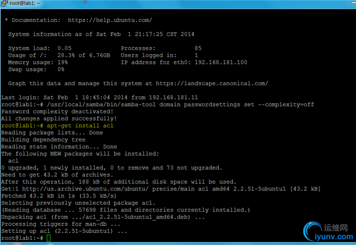

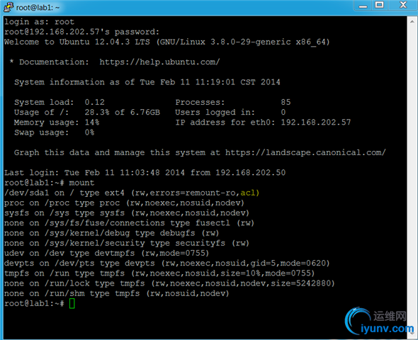

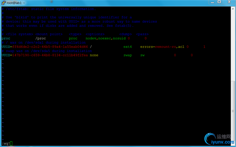

apt-get install acl install acl package
48
vim /etc/fstab set acl to desired partition to enable ACL
49
mount check if ACL is ok for your partition
50
reboot force ACL work for your ACL partition
51
mount confirm acl is enabled
52

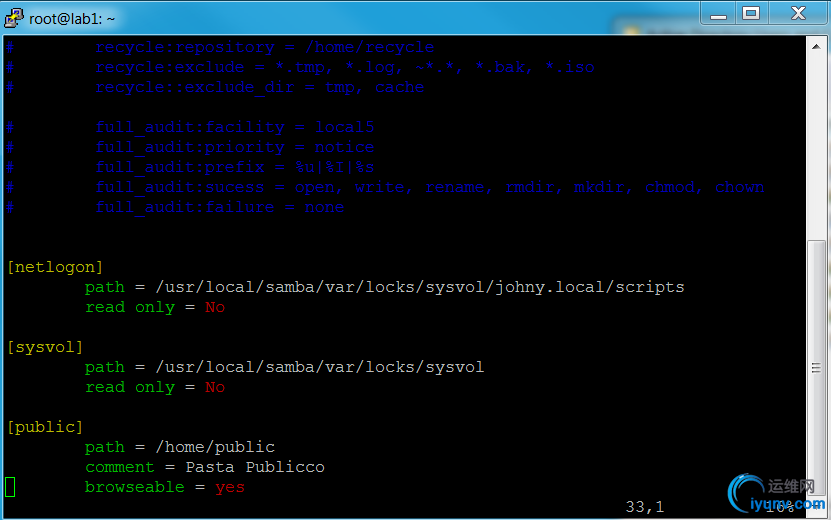

smb.conf
Configuration
Description
# Global parameters the file is divided into sections
[global] the first is always the ”[global]” section, which contains the general server options
workgroup = JOHNY the name of the workgroup
realm = JOHNY.LOCAL
netbios name = LAB5 server name
server role = active directory domain controller the server was configured as a AD and DC
dns forwarder = 8.8.8.8
vfs objects = recycle, full_auditVFS module records selected client operations to the system log
recycle:keeptree = yesSpecifies whether the directory structure should be preserved or whether the files in a directory that is being deleted should be kept separately in the repository
recycle:versions = yesIf this option is True, two files with the same name that are deleted will both be kept in the repository. Newer deleted versions of a file will be called “Copy #x of filename”.
recycle:repository = /home/recyclePath of the directory where deleted files should be moved
recycle:exclude = *.tmp, *.log, ~*.*, *.bak, *.isoList of files that should not be put into the repository when deleted, but deleted in the normal way. Wildcards such as * and ? are supported.
recycle::exclude_dir = tmp, cacheList of directories whose files should not be put into the repository when deleted, but deleted in the normal way. Wildcards such as * and ? are supported
full_audit:facility = local5all this audit logs are going to system log(/var/log/syslog)
full_audit:priority = notice
full_audit:prefix = %u%I%s adds additional useful information to audit log file.%u – User; %I – User IP address; %S – Server share name
full_audit:sucess = open, write, rename, rmdir, mkdir, chmod, chown
full_audit:failure = nonedo not give a list of VFS operations that should be recorded if they failed
log level = 5
[netlogon] indicates the name of sharing,describes a shared resource (known as a “share”).
path = /usr/local/samba/var/locks/sysvol/johny.local/scriptsshare folder path
read only = No
[sysvol]
read only = No
[public] name of the share folder
path = /home/public
path of the share folder
comment = Pasta Publicco
description of the share folder
browseable = yesThis controls whether this share is seen in the list of available shares in a net view and in the browse list.
create mask = 0777This setting tells samba what permissions to mask against the DOS/Windows assigned permissions for a new file when it is created from a Windows/DOS client
writeable = yes
directory mask = 0777
force directory mode = 0777
map acl inherit = yesThis parameter can be used to ensure that if default acls exist on parent directories, they are always honored when creating a new file or subdirectory in these parent directories
[it]
    path = /home/it    comment = Pasta IT    browseable = yes    create mask = 0770    writeable = yes    directory mask = 0770    force directory mode = 0770    map acl inherit = yes
    path = /home/hr    comment = Pasta HR    browseable = yes    create mask = 0770    writeable = yes    directory mask = 0770    force directory mode = 0770    map acl inherit = yes[commercial]
    path = /home/commercial    comment = Pasta Commercial    browseable = yes    create mask = 0770    writeable = yes    directory mask = 0770    force directory mode = 0770    map acl inherit = yes

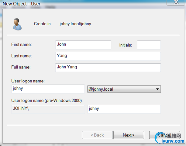

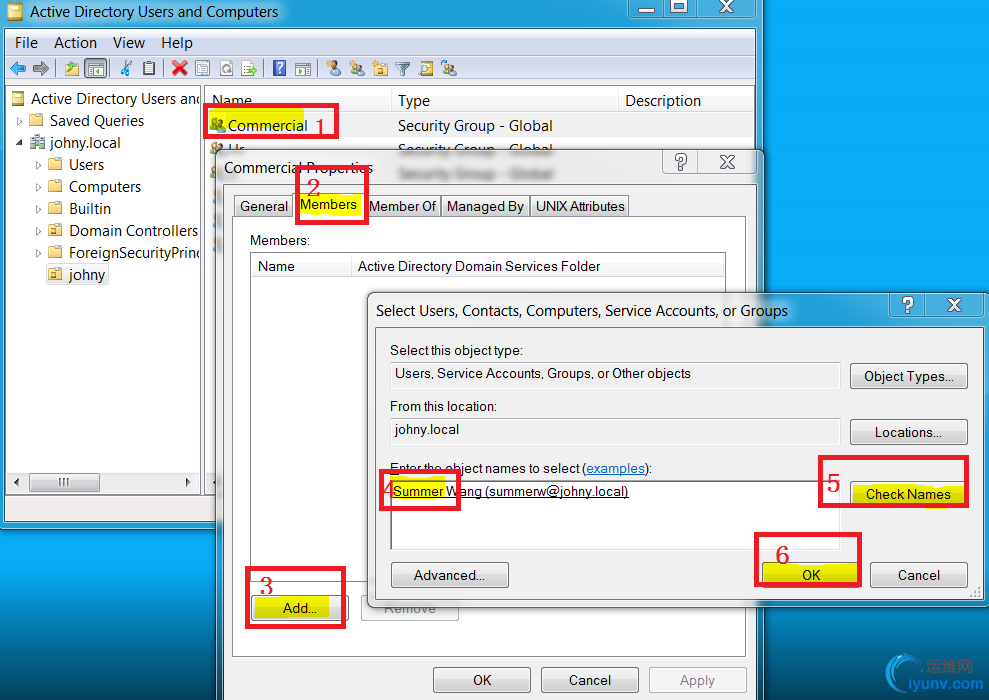

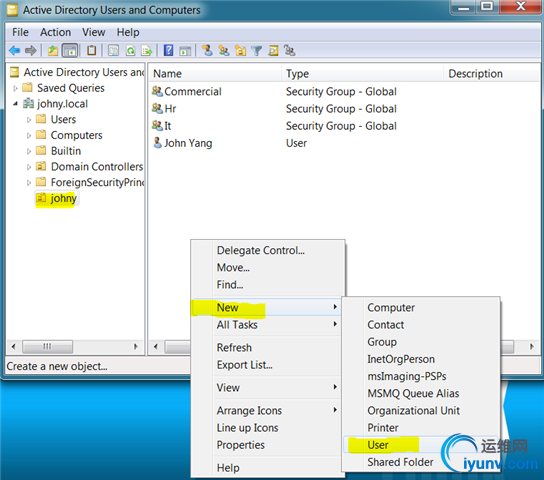

Add a user test /usr/local/samba/bin/samba-tools user add test
Add group level1 /usr/local/samba/bin/samba-tool group add level1
Add user1 to group level1 /usr/local/samba/bin/samba-tool group addmembers “level1” user1
Remove user1 from group level1 /usr/local/samba/bin/samba-tool group removemembers “level1” user1
List the current group /usr/local/samba/bin/samba-tool group list
List the current user /usr/local/samba/bin/samba-tool user list
Add a user test /usr/local/samba/bin/samba-tool user create test
Delete a user test /usr/local/samba/bin/samba-tool user delete test
Delete a group test /usr/local/samba/bin/samba-tool group delete test
Add a user test to ou yanling /usr/local/samba/bin/samba-tools user add test –userou=OU=yanling
Add a user group to ou yanling /usr/local/samba/bin/samba-tools group add grouptest –groupou=OU=yanling

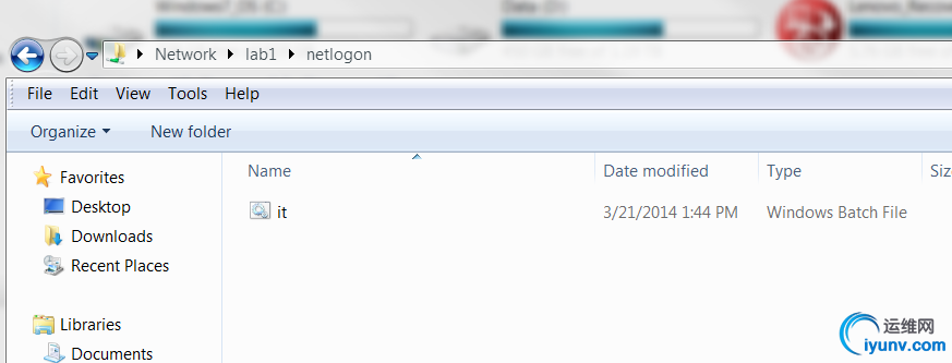

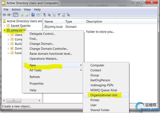

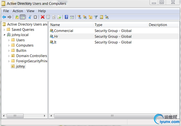

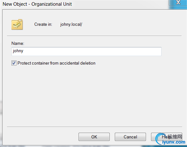

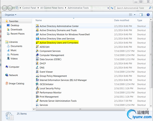

netlogon script for map network drivers1) Copy the bat files to \\sambaserver\netlogon folder
below is its samba path
2) add the bat file to user by “Active Directory Users and Computers”

40
apt-get install build-essential libacl1-dev libattr1-dev libblkid-dev libgnutls-dev libreadline-dev python-dev python-dnspython gdb pkg-config libpopt-dev libldap2-dev
41
cd /root/
42
ls
43
tar zxvf samba-4.1.4.tar.gz
44
cd samba-4.1.4/
45
./configure –enable-debug
47
make
48
make install
49
vim /etc/hostname
50
vim /etc/resolv.conf
51
ping lab1
52
cd /usr/local/samba/etc/
53
ls
54
cd
55
apt-get install krb5-user
56
kinit administrator@JOHNY.LOCAL
57
klist
58
host -t dc lab2.johny.local of course will failed
59
cd /usr/local/samba/bin/
60
ls
63
cd /
64
/usr/local/samba/bin/samba-tool domain join johny.local DC -Uadministrator –realm=johny.local
65
host -t A lab2.johny.local
66
/usr/local/samba/bin/samba-tool dns add 192.168.202.57 johny.local lab2 A 192.168.202.53 -Uadministrator
67
68
/usr/local/samba/bin/ldbsearch -H /usr/local/samba/private/sam.ldb '(invocationid=*)' –cross-ncs objectguid
69
host -t CNAME d40ea8d6-5e70-4b8b-ba3c-8ca20fe4451f._msdcs.demo.local
70
host -t CNAME d40ea8d6-5e70-4b8b-ba3c-8ca20fe4451f._msdcs.johny.local
71
72
ls
73
vim smb.conf it already created a smb.conf file
74
cd..
75
cd ..
76
cd bin/
77
ls
78
cd
79
82
cd /etc/init.d/scp samba4 from other samba server
83
ls
84
ls samba4
86
/etc/init.d/samba4 restart
88
cd
89
getent passwd
90
ping lab1
98
99
100
101
ldconfig -v grep winbind
102
103
104
105
/usr/local/samba/bin/wbinfo -p
106
/usr/local/samba/bin/wbinfo -u
107
getent passwd

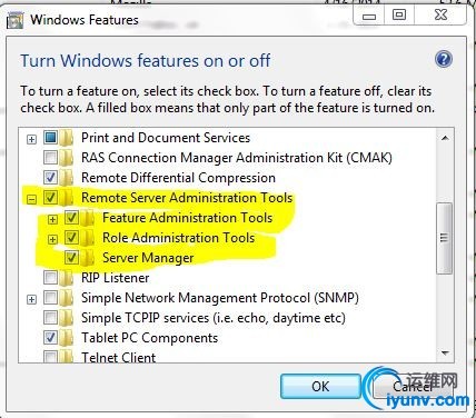

Install remote administration tools in windows to manage the users and computers1.login to your domain with administrator, search tools by google and download it to ftp then install itDownload: http://www.microsoft.com/zh-cn/download/details.aspx?id=7887
Install:
2.run administrative tools's Active Directory users and computers to add a OU and 3 uers and groups in it
Add OU
New OU
Add Group in johny OU
New Group – It;Commercial;Hr
Add Users
New User – johny
you also can create the user in Linux but it's not in your OU
Accociate the users with the groups

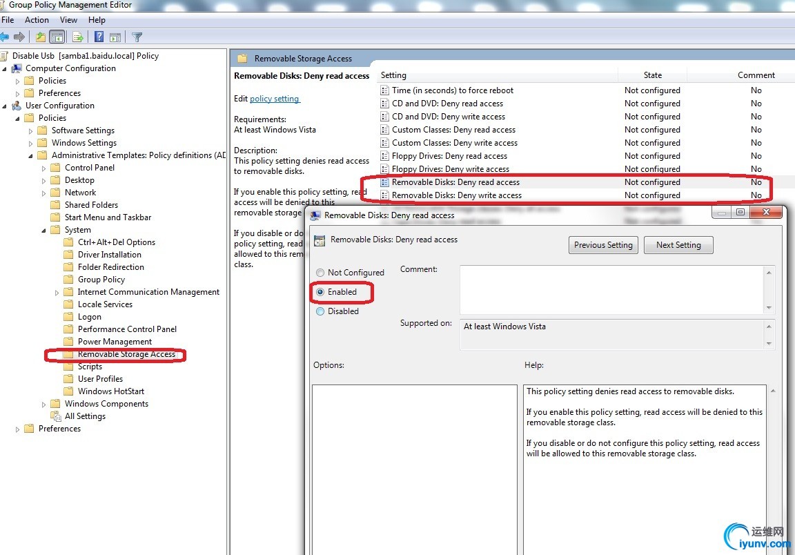

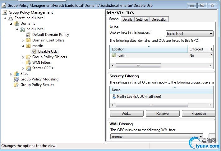

create group policyGoal

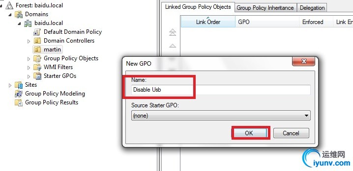

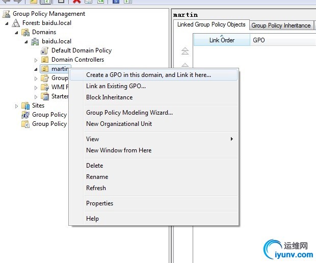

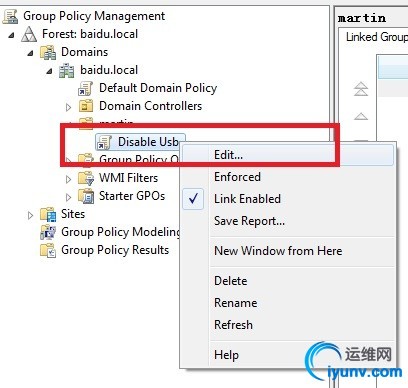

Control Domain(baidu.local) user martin.lee can't use Usb Removable Disk by Group policy.How To

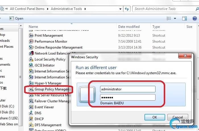

1: Runas ad administrator /Control Panel/Adminstative Tools/Group Policy Management
2:Right click OU, Create a GPO in this domain......
3:Give name to GPO
4:Right click the GPO, Edit
5:User configuration--Administrative templates......--System--Removable storage access. Enable option Removable disks: read and write.

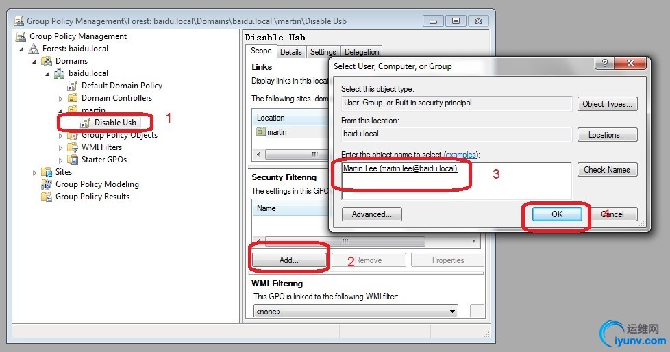

6:Add domain user martin.lee to apply the GPO, step as below.
7: Finish:
Install ACL and setup it and confirm it worksapt-get install acl
setup ACL in fstabvim /etc/fstabAdd acl behind "errors=remount-ro,"
Reboot and mount  (to confirm the acl work)
Smb.confBackup original smb.conf file and copy below to create a new smb.conf fileroot@lab5:/home# vim /usr/local/samba/etc/smb.conf
# Global parameters
[global]      workgroup = JOHNY      realm = JOHNY.LOCAL      netbios name = LAB5      server role = active directory domain controller      dns forwarder = 8.8.8.8      vfs objects = recycle, full_audit      recycle:keeptree = yes      recycle:versions = yes      recycle:repository = /home/recycle      recycle:exclude = *.tmp, *.log, ~*.*, *.bak, *.iso      recycle::exclude_dir = tmp, cache      full_audit:facility = local5      full_audit:priority = notice      full_audit:prefix = %u|%I|%s      full_audit:sucess = open, write, rename, rmdir, mkdir, chmod, chown      full_audit:failure = none      log level = 5[netlogon]      path = /usr/local/samba/var/locks/sysvol/johny.local/scripts      read only = No[sysvol]      path = /usr/local/samba/var/locks/sysvol      read only = No[public]      path = /home/public      comment = Pasta Publicco      browseable = yes      create mask = 0777      writeable = yes      directory mask = 0777      force directory mode = 0777      map acl inherit = yes[it]      path = /home/it      comment = Pasta IT      browseable = yes      create mask = 0770      writeable = yes      directory mask = 0770      force directory mode = 0770      map acl inherit = yes
      path = /home/hr      comment = Pasta HR      browseable = yes      create mask = 0770      writeable = yes      directory mask = 0770      force directory mode = 0770      map acl inherit = yes[commercial]      path = /home/commercial      comment = Pasta Commercial      browseable = yes      create mask = 0770      writeable = yes      directory mask = 0770      force directory mode = 0770      map acl inherit = yes
