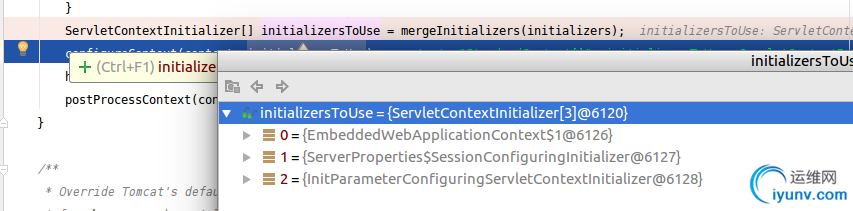

  接着是是否注册jspServlet,jasperInitializer和StoreMergedWebXmlListener我这里是都没有的。接着的mergeInitializers方法:
    protected final ServletContextInitializer[] mergeInitializers(  ServletContextInitializer... initializers) {
  List
<ServletContextInitializer> mergedInitializers = new ArrayList<ServletContextInitializer>();  mergedInitializers.addAll(Arrays.asList(initializers));
this.initializers);return mergedInitializers  .toArray(
new ServletContextInitializer[mergedInitializers.size()]);  }
