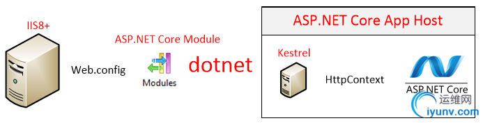

  In ASP.NET>  In ASP.NET Core (latest version 1.0) your web application is loaded into it's own separate process together with an instance of Kestrel - together called ASP.NET Core App Host. The ASP.NET Core App Host process is startet by dotnet run, which is executed by ASP.NET Core Module from within IIS. The ASP.NET Core App Host will through Kestrel listen to a specific port and the ASP.NET Core Module will forward requests to that port.
  In the above schematic IIS will map (eg. through http host header) an http request to a specific web application. The web application uses a web.config file to configure IIS to use ASP.NET Core Module for this web application. ASP.NET Core Module will use dotnet to load the web application as an ASP.NET Core App Host in an external process setting up a port (default 5000) based communication between the ASP.NET Core Module and the ASP.NET Core App Host. ASP.NET Core Module is then forwarding http requests to ASP.NET Core App Host. Inside of ASP.NET Core App Host the Kestrel part will poll the port and then receiving a request building an array of context>HttpContext, which is then made available for the ASP.NET Core App.
  While indeed there are other ways to host ASP.NET Core, the above schematic is the current Microsoft recommended way to host ASP.NET Core on a Windows server (note that Kestrel is a cross platform web server and while I often read about how fast Kestrel is, the upcoming Windows only web server called WebListener should be even faster - as WebListener matures Microsoft may change their recommendation to use WebListener on Windows servers).
  The ASP.NET Core App Host is running by itself and listening to http requests by itself as well - it will work all by itself. It is NOT necessary to use IIS or another webserver as a frontend (reverse proxy) for the ASP.NET Core App Host. However there are several reasons why the reverse proxy topology recommeded by microsoft is a good>
  • Kestrel does NOT support http host header redirect - so with Kestrel only we can have only one web application on port 80.
  • ASP.NET Core module guarantees that the ASP.NET Core App Host is loaded and also restarted if necessary - if manually starting up an ASP.NET Core App Host from the command prompt and the process crashes, you are responsible yourself to startup the app again.
  • IIS can handle cashing, SSL and static content compression (I am not confident to which extent Kestrel can do these and there may be a host of other details better handled by IIS).
