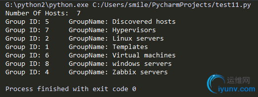

  2.hostgroup.get方法获取所有主机组ID。把第一步获得的认证密钥填写到“auth”中,每次获取数据时都需要认证。此处是获取zabbix server上的所有主机组名称与ID号。
  官方地址:https://www.zabbix.com/documentation/3.4/zh/manual/api/reference/hostgroup/get
  python实现方法:
#!/usr/bin/env python2.7
coding=utf-8
import json
import urllib2
# based url and required header
url = "http://192.168.0.217/zabbix/api_jsonrpc.php"
header = {"Content-Type":"application/json"}
# request json
data = json.dumps(
  "jsonrpc":"2.0",
  "method":"hostgroup.get",
  "params":{
  "output":["groupid","name"],
  "auth":"4c38be0e3cda326c63e4f4be8f73a056", # theauth>  "id":1,
# create request object
request = urllib2.Request(url,data)
for key in header:
  request.add_header(key,header[key])
# get host list
try:
  result = urllib2.urlopen(request)
except urllib2.URLError as e:
  if hasattr(e, 'reason'):
  print 'We failed to reach a server.'
  print 'Reason: ', e.reason
  elif hasattr(e, 'code'):
  print 'The server could not fulfill the request.'
  print 'Error code: ', e.code
else:
  response = json.loads(result.read())
  result.close()
  print "Number Of Hosts: ", len(response['result'])
  #print response
  for group in response['result']:
  print "Group>

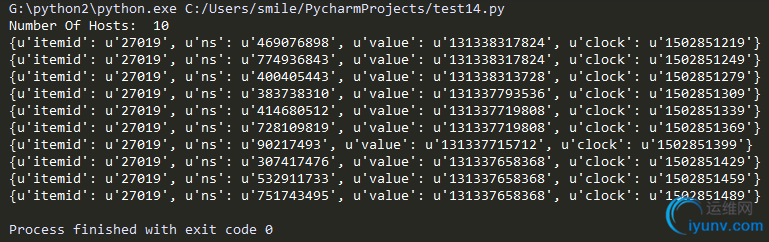

  5.history.get方法获取单个监控项的历史数据。根据第4点获取到的所有items>
  官方地址:https://www.zabbix.com/documentation/3.4/zh/manual/api/reference/history/get
  python实现方法:
coding=utf-8
import json
import urllib2
# request json
data = json.dumps(
  "jsonrpc":"2.0",
  "method":"history.get",
  "params":{
  "output":"extend",
  "history":3,
  "itemids":"27019",
  "limit":10
for key in header:
# get host list
try:
else:
  result.close()
  for host in response['result']:
  print host
  #print "Host>
