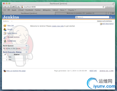

  You will setup and manage Jenkins iOS using a browser that points to a website URL. Typically it will be accessible via http://localhost:8080 while you are on the machine Jenkins iOS is installed.

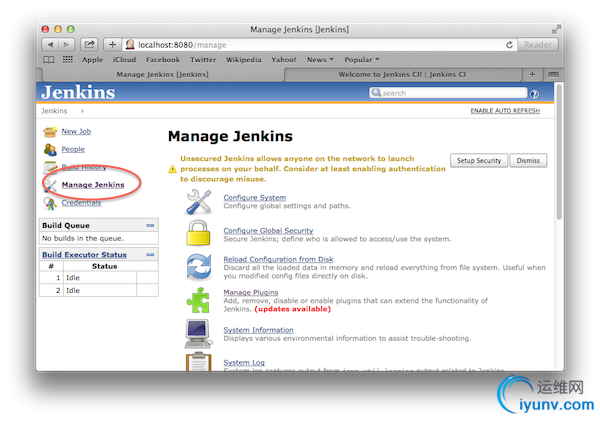

  At the Root of the Jenkins website Select Manage Jenkins –> Select Manage Plugins

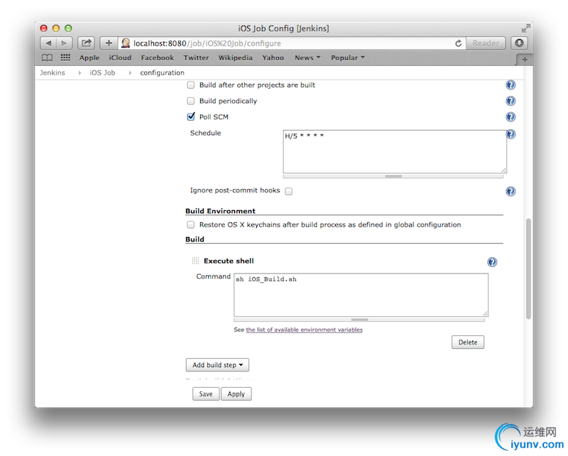

  Step 3: Add and Setup SCM Polling
  In the Build Triggers section of the Job Configuration screen you will be able define the polling Interval. These configuration accepts cron syntax to define the polling schedule.
  Simply Check the Poll SCM check box and define your cron schedule. Below illustrates a 5 min polling (this is too often of a schedule to run all the time but for tutorial and testing purposes it is acceptable).

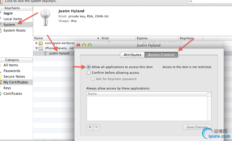

  If you where prompted for a password during the code signing/archiving command then you will need to change your certificate’saccess control settings.
  Open Keychain Access
  Click System and My Certificates in the left hand side of the window and Click the lock to unlock the system keychain.
  Expand your iOS certificate to expose your private key and Double Click the key.
  Click Access Control tab and ensure Allow all applications to access this item is selected.
  Click Save Changes
  If you where prompted for a password during the build script execution, try it again to make sure you are not required to enter a password.
  Once your build is successfully simply add a new Execute Shell command build step in Jenkins and enter sh iOS_Build.shand your done.

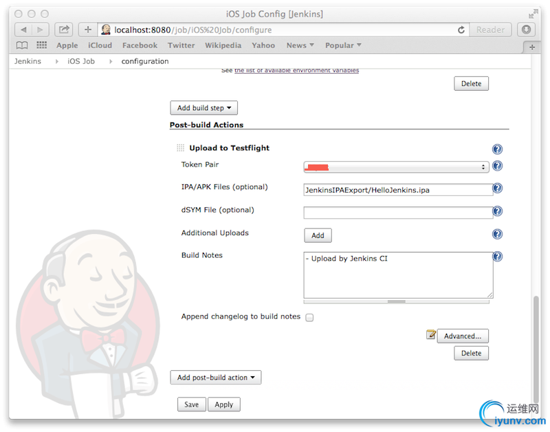

  Step 5: Add and Setup Post Build Step – Jenkins iOS TestFlight Upload
  TestFlight is a great way to distribute beta and internal applications. I have used it with great success. Likely, there is a Jenkins Plugin to upload your automated builds.
  Once you have created a TestFlight account the configuration is simple. Navigate to the TestFlight API Doc page and get yourAPI_Token and your Team_Token.
  You token pair needs to be setup in: Jenkins Dashboard –> Configure System –> Scroll to TestFlight section, Enter your tokens and Click Save.
  Back to the Jenkins iOS job. All you need to do is Select your Token pair setup previously and enter your .ipa file location (relative to your job’s workspace folder). Additionally, you can setup a distribution list on TestFlight for sending out notifications via Jenkins upload. After you setup a distribution list on TestFlight, supply that name in the advanced section of the Jenkins Plugin. Now you have email notifications via TestFlight.
