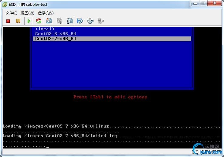

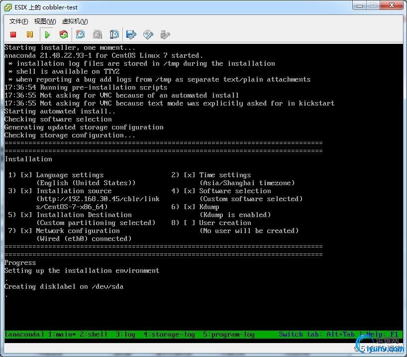

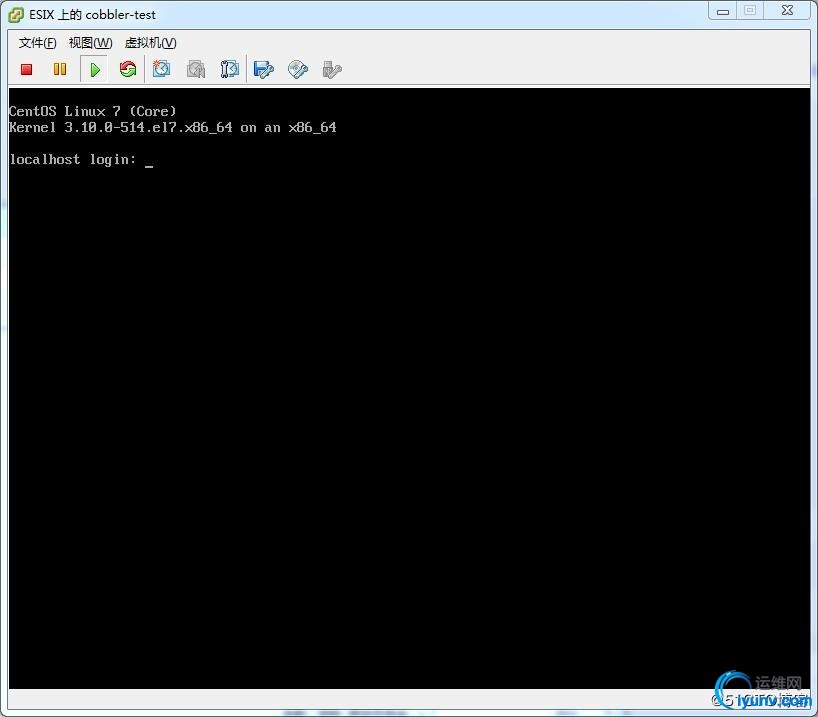

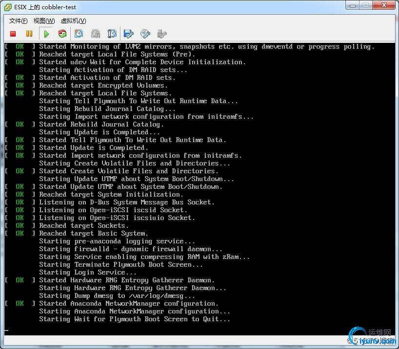

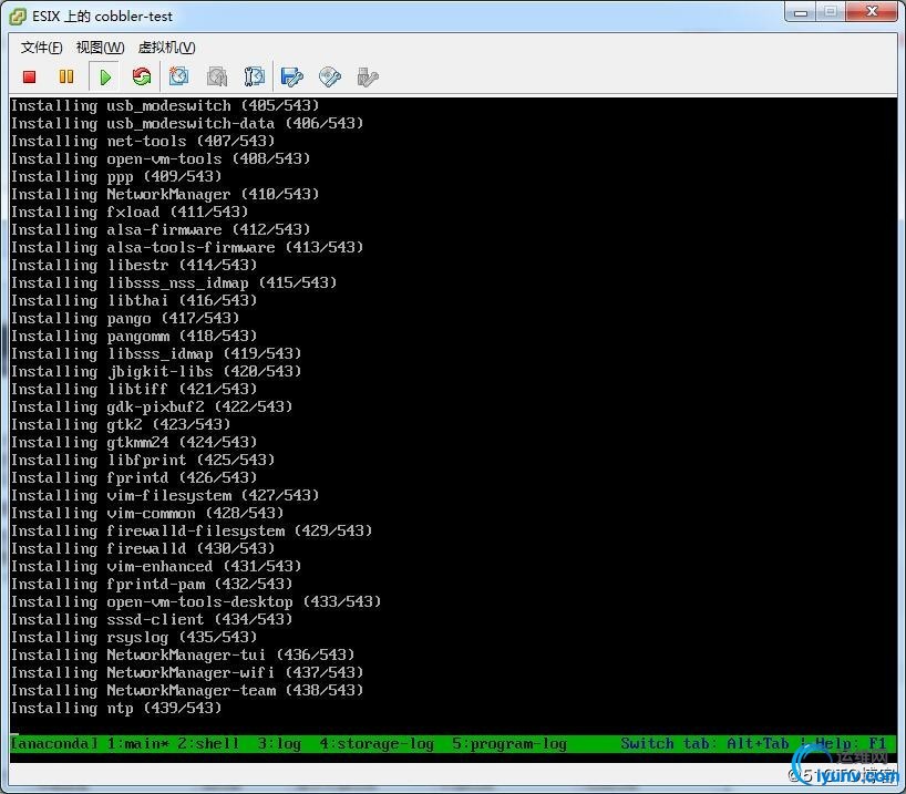

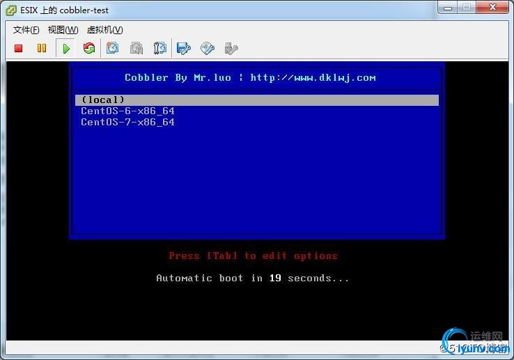

到这为止cobbler自动安装系统server已经安装完成了,接下来就是找台客户端来验证
watermark,size_16,text_QDUxQ1RP5Y2a5a6i,color_FFFFFF,t_100,g_se,x_10,y_10,shadow_90,type_ZmFuZ3poZW5naGVpdGk=
