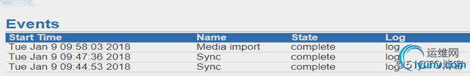

  cobbler同步
[root@Cobbler ~]# cobbler sync
task started: 2018-01-09_094453_sync
task started (id=Sync, time=Tue Jan  9 09:44:53 2018)
running pre-sync triggers
cleaning trees
removing: /var/lib/tftpboot/grub/images
copying bootloaders
trying hardlink /var/lib/cobbler/loaders/pxelinux.0 -> /var/lib/tftpboot/pxelinux.0
trying hardlink /var/lib/cobbler/loaders/menu.c32 -> /var/lib/tftpboot/menu.c32
trying hardlink /var/lib/cobbler/loaders/yaboot -> /var/lib/tftpboot/yaboot
trying hardlink /usr/share/syslinux/memdisk -> /var/lib/tftpboot/memdisk
trying hardlink /var/lib/cobbler/loaders/grub-x86.efi -> /var/lib/tftpboot/grub/grub-x86.efi
trying hardlink /var/lib/cobbler/loaders/grub-x86_64.efi -> /var/lib/tftpboot/grub/grub-x86_64.efi
copying distros to tftpboot
copying images
generating PXE configuration files
generating PXE menu structure
rendering DHCP files
generating /etc/dhcp/dhcpd.conf
rendering TFTPD files
generating /etc/xinetd.d/tftp
cleaning link caches
running post-sync triggers
running python triggers from /var/lib/cobbler/triggers/sync/post/*
running python trigger cobbler.modules.sync_post_restart_services
running: dhcpd -t -q
received on stdout:
received on stderr:
running: service dhcpd restart
received on stdout:
received on stderr: Redirecting to /bin/systemctl restart dhcpd.service
  running shell triggers from /var/lib/cobbler/triggers/sync/post/
running python triggers from /var/lib/cobbler/triggers/change/
running python trigger cobbler.modules.scm_track
running shell triggers from /var/lib/cobbler/triggers/change/*
TASK COMPLETE

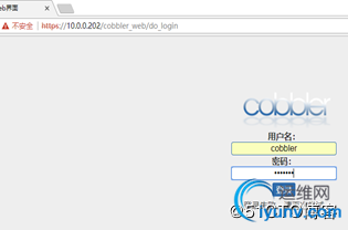

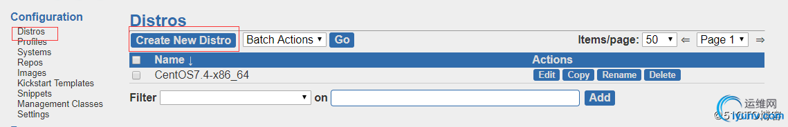

  登录cobbler的web界面
  https://10.0.0.202/cobbler_web

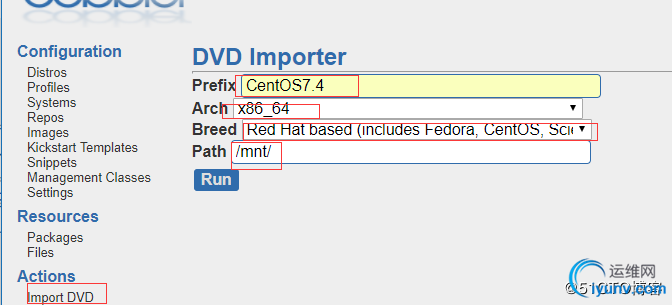

  虚拟机磁盘挂载
[root@Cobbler ~]# mount /dev/cdrom /mnt/
mount: /dev/sr0 is write-protected, mounting read-only
[root@Cobbler ~]# df -h
Filesystem      Size  Used Avail Use% Mounted on
/dev/sda3        98G  1.6G   97G   2% /
devtmpfs        903M     0  903M   0% /dev
tmpfs           912M     0  912M   0% /dev/shm
tmpfs           912M  8.6M  904M   1% /run
tmpfs           912M     0  912M   0% /sys/fs/cgroup
/dev/sda1      1014M  135M  880M  14% /boot
tmpfs           183M     0  183M   0% /run/user/0
/dev/sr0        4.3G  4.3G     0 100% /mnt
  查看是否导入
[root@Cobbler ~]# ps -ef|grep rsync
root      11796      1  0 09:20 ?        00:00:00 /usr/bin/rsync --daemon --no-detach
root      12205  11869 27 09:58 ?        00:00:03 rsync -a /mnt/ /var/www/cobbler/ks_mirror/CentOS7.4-x86_64 --progress
root      12206  12205  0 09:58 ?        00:00:00 rsync -a /mnt/ /var/www/cobbler/ks_mirror/CentOS7.4-x86_64 --progress
root      12207  12206 32 09:58 ?        00:00:04 rsync -a /mnt/ /var/www/cobbler/ks_mirror/CentOS7.4-x86_64 --progress
root      12217  10658  0 09:58 pts/0    00:00:00 grep --color=auto rsync

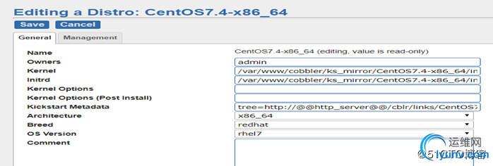

镜像文件
[root@Cobbler ~]# ls  /var/www/cobbler/ks_mirror/
CentOS7.4-x86_64  config
  http://***@@httpserver@@***/cblr/links/CentOS7.4-x86_64 ==http://**10.0.0.202**/cblr/links/CentOS7.4-x86_64/

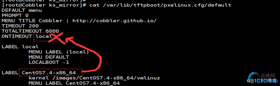

  界面配置文件  可以修图

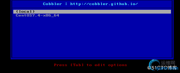

[root@Cobbler ~]# cat /etc/cobbler/pxe/pxedefault.template
DEFAULT menu
PROMPT 0
MENU TITLE Cobbler | http://cobbler.github.io/
TIMEOUT 200
TOTALTIMEOUT 6000
ONTIMEOUT $pxe_timeout_profile
  LABEL local
MENU LABEL (local)
MENU DEFAULT
LOCALBOOT -1
  $pxe_menu_items
  MENU end
  不想要local可以修改

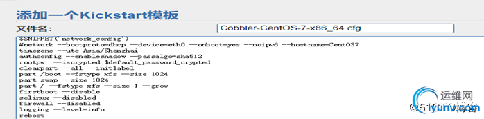

  自定义安装系统
  Cobbler-CentOS-7-x86_64.cfg
  #Cobbler for Kickstart Configurator for CentOS 7 by yao zhang
  install
url --url=$tree
text
lang en_US.UTF-8
keyboard us
zerombr
bootloader --location=mbr --driveorder=sda --append=&quot;crashkernel=auto rhgb quiet&quot;
#Network information
$SNIPPET('network_config')
#network --bootproto=dhcp --device=eth0 --onboot=yes --noipv6 --hostname=CentOS7
timezone --utc Asia/Shanghai
authconfig --enableshadow --passalgo=sha512
rootpw  --iscrypted $default_password_crypted
clearpart --all --initlabel
part /boot --fstype xfs --size 1024
part swap --size 1024
part / --fstype xfs --size 1 --grow
firstboot --disable
selinux --disabled
firewall --disabled
logging --level=info
reboot
  %pre
$SNIPPET('log_ks_pre')
$SNIPPET('kickstart_start')
$SNIPPET('pre_install_network_config')
#Enable installation monitoring
$SNIPPET('pre_anamon')
%end
  %packages@^minimalbr/>@core
