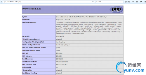

测试短语、
vim /usr/share/nginx/html/a.php
<?php
        phpinfo();
http://ip/a.php
如出现以上界面 表示lnmp环境搭建成功

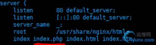

如果访问网址的时候回报错 解决方法:
location ~ \.php$ {
        root           html;
        fastcgi_pass   127.0.0.1:9000;
        fastcgi_index  index.php;
        fastcgi_param  SCRIPT_FILENAME  /usr/share/nginx/html$fastcgi_script_name;
        include        fastcgi_params;

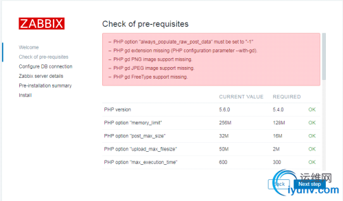

出现报错
解决方法:
PHP option always_populate_raw_post_data must be set to -1
打开/usr/local/php56/etc/php.ini文件把always_populate_raw_post_data = -1这一行注释打开,保存重启php-fpm56

解决办法:
yum install libpng-devel,下面就是编译安装
./configure --with-php-config=/usr/local/php56/bin/php-config  --with-jpeg-dir=/usr/local/jpeg  --with-png-dir=/usr/local/libpng   --with-freetype-dir=/usr/local/freetype
make && make install
接着修改php.ini文件 ; default extension directory. 下面添加一行extension=gd.so

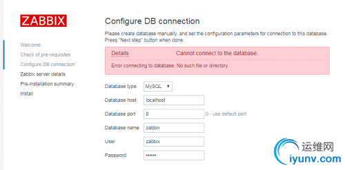

输入密码123456
解决方法
ln -s /var/lib/mysql/mysql.sock /tmp/
vim /usr/local/php56/etc/php.ini
mysqli.default_socket = /var/lib/mysql/mysql.sock
/etc/init.d/php-fpm56 restart

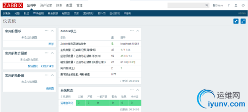

然后一直下一步 输入用户名Admin,密码zabbix
