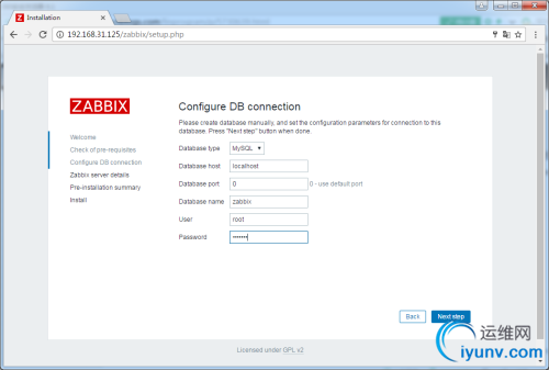

  1.5、创建Zabbix数据库
  mysql -uroot -pkingdee
  mysql> create database zabbix character set utf8 collate utf8_bin;
  Query OK, 1 row affected (0.04 sec)
  mysql> grant all privileges on zabbix.* to zabbix@localhost>  Query OK, 0 rows affected (0.01 sec)
  mysql> FLUSH PRIVILEGES;
  mysql> quit

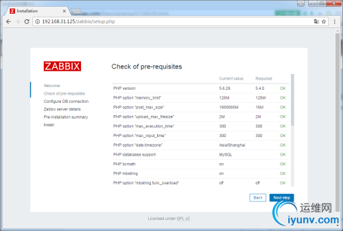

  2、安装PHP
  2.1、安装PHP
  rpm -ivh http://repo.webtatic.com/yum/el6/latest.rpm
  yum install -y httpd libxml2-devel net-snmp-devel libcurl-devel php56w php56w-gd php56w-mysql php56w-bcmath php56w-mbstring php56w-xml php56w-ldap
  2.2、修改PHP配置文件
  vim /etc/php.ini
  post_max_size=16M
  max_execution_time=300
  max_input_time=300
  date.timezone=Asia/Shanghai
  always_populate_raw_post_data=-1
  2.3、设置HTTP自动启动并启动HTTP
  chkconfig httpd on
  service httpd start

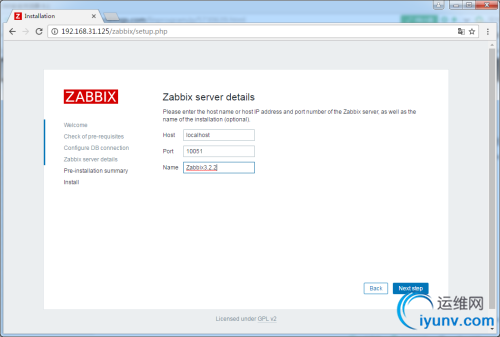

  3.4、修改Zabbix Sever配置
  vim /etc/zabbix/zabbix_server.conf
  DBHost=localhost
  DBName=zabbix
  DBUser=zabbix
  DBPassword=zabbix

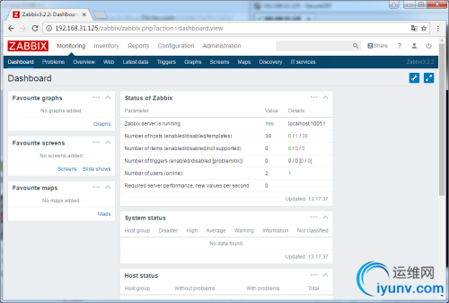

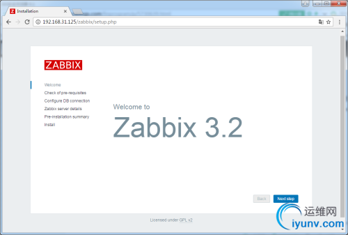

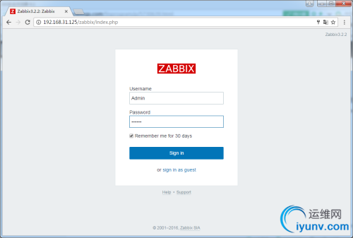

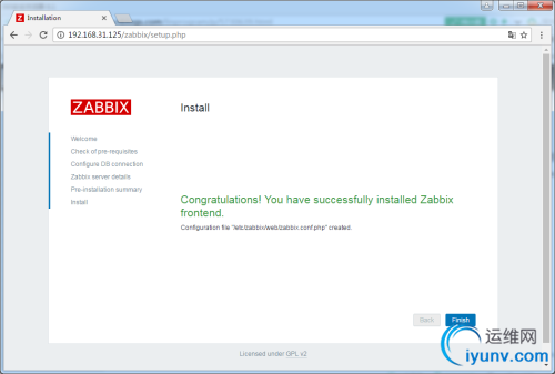

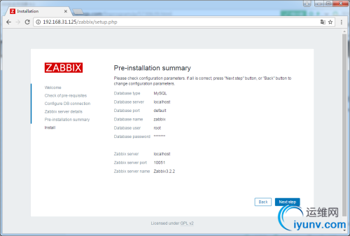

  4、浏览器配置Zabbix
  默认账号为:Admin 默认密码为:zabbix
  点击右上角头像,选择中文,更新一下即可显示中文。
