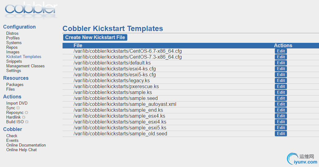

CentOS-7.3-x86_64  config  默认kickstart文件存放位置:/var/lib/cobbler/kickstarts/
[root@cobbler ~]# cd /var/lib/cobbler/kickstarts/

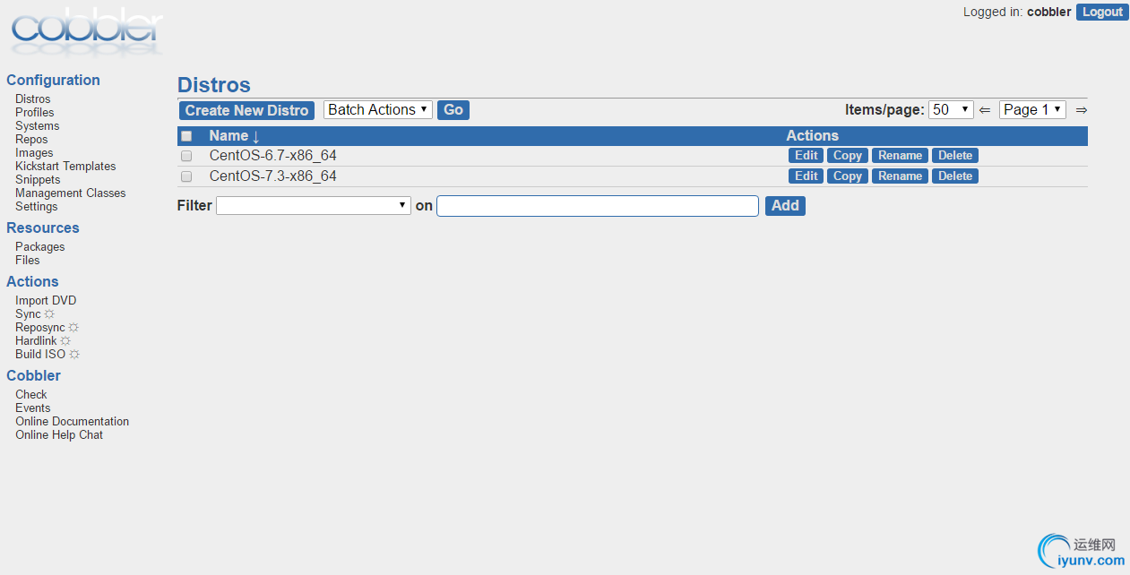

[root@cobbler ~]# cobbler list
distros:
   CentOS-7.3-x86_64

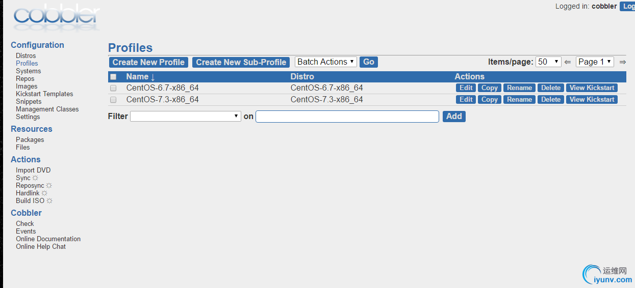

[root@cobbler ~]# cobbler profile report

                        other items  修改kickstart文件:
[root@cobbler ~]# cobbler profile edit --name=CentOS-7.3-x86_64 --kickstart=/var/lib/cobbler/kickstarts/CentOS-7.3-x86_64.cfg  修改内核参数:
[root@cobbler ~]# cobbler profile edit --name=CentOS-7.3-x86_64 --kopts='net.ifnames=0 biosdevname=0'
TFTP Boot Files                : {}
Comment                        :
DHCP Tag                       : default
Distribution                   : CentOS-7.3-x86_64
Enable gPXE?                   : 0
Enable PXE Menu?               : 1
Fetchable Files                : {}
Kernel Options                 : {'biosdevname': '0', 'net.ifnames': '0'}
Kernel Options (Post Install)  : {}
Kickstart                      : /var/lib/cobbler/kickstarts/CentOS-7.3-x86_64.cfg
Kickstart Metadata             : {}
Management Classes             : []
Management Parameters          : <<inherit>>
Name Servers                   : []
Name Servers Search Path       : []
Owners                         : ['admin']
Parent Profile                 :
Internal proxy                 :
Red Hat Management Key         : <<inherit>>
Red Hat Management Server      : <<inherit>>
Repos                          : []
Server Override                : <<inherit>>
Template Files                 : {}
Virt Auto Boot                 : 1
Virt Bridge                    : xenbr0
Virt CPUs                      : 1
Virt Disk Driver Type          : raw
Virt File Size(GB)             : 5
Virt Path                      :
Virt RAM (MB)                  : 512
Virt Type                      : kvm

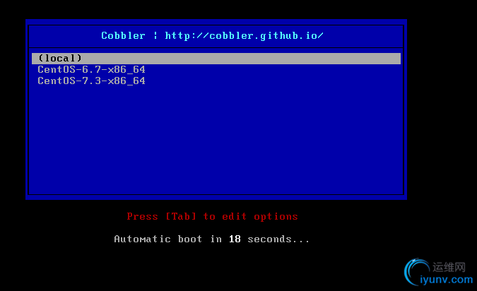

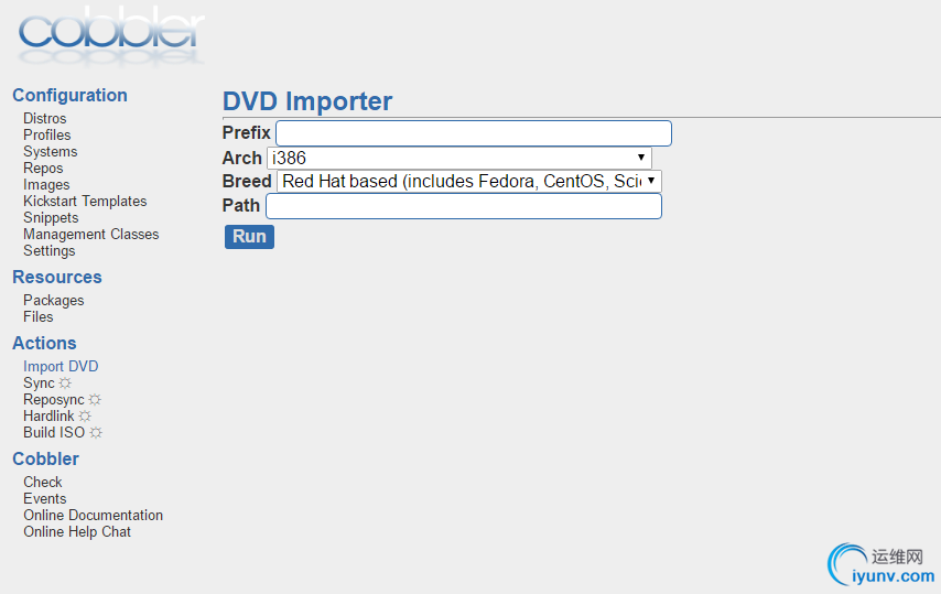

*** TASK COMPLETE ***  客户端设置从网卡启动:

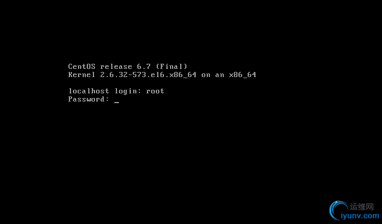

  安装完的CentOS6:

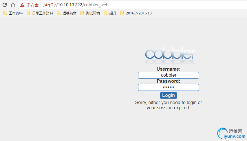

  cobbler的图形化管理界面(默认用户名cobbler,默认密码cobbler):
