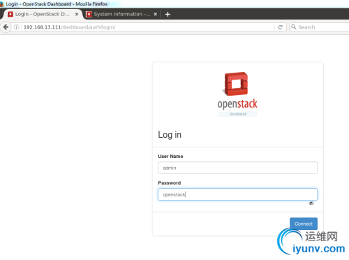

  * File /root/keystonerc_admin has been created on OpenStack client host 192.168.13.111. To use the command line tools you need to source the file.
  * To access the OpenStack Dashboard browse to http://192.168.13.111/dashboard .
  Please, find your login credentials stored in the keystonerc_admin in your home directory.

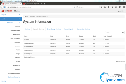

  [root@controller ~(keystone_admin)]# openstack service list
  | ID                               | Name       | Type            |
  | 286a239647284235a2d3cc9147437254 | heat       | orchestration   |
  | 2a117f7dcb6c4c8fbfa014a5f8326bf8 | cinder     | volume          |
  | 350da74d69b54c858998952486234509 | manilav2   | sharev2         |
  | 3660afe3906f4f1ebdb98589e50f8211 | cinderv3   | volumev3        |
  | 4c96091e17e945e2a6e27f65d4d6feac | neutron    | network         |
  | 5d70f4767d2b4e90bde59fd384ce386a | keystone   | identity        |
  | 8bf3c2e53a86421da38909f6b40780ae | manila     | share           |
  | 8ef87dedae0544ac96c156cd66cd0afc | aodh       | alarming        |
  | 9627f0c7d2a54e2ca86372ce18181e2f | nova       | compute         |
  | 988cb4ca952e4e82a14eaf3cfe6656f8 | cinderv2   | volumev2        |
  | aa1a52506e1140289d3137e142c90798 | trove      | database        |
  | b2eb0ba2d20944e5b40f243be6bc59ef | ceilometer | metering        |
  | bc429bc6b4f0494fb5b14d2a8792f453 | sahara     | data-processing |
  | d387736abf0643c2bd6fa1783cf7b6dd | heat-cfn   | cloudformation  |
  | dc249c4c91154a788018c13f49c8412e | glance     | image           |
  | e35245e5f3f84655b9ddfea9d90e24b7 | swift      | object-store    |
