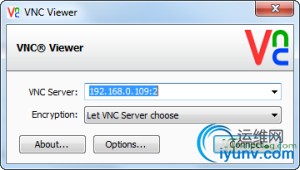

  7. Use VNC Viewer and connect to VNC Server (Centos 6.8) with user lb
  http://www.realvnc.com/download/viewer/
