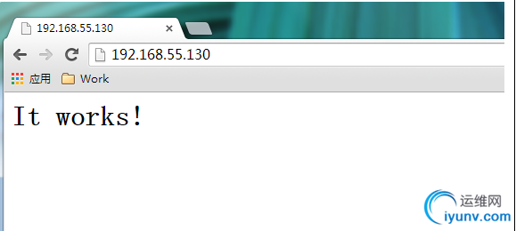

4) apache
[root@localhost ~]# cd /usr/local/src/
[root@localhost ~]# wget http://mirrors.cnnic.cn/apache//httpd/httpd-2.4.17.tar.gz
[root@localhost src]# tar zxvf httpd-2.4.17.tar.gz
[root@localhost src]# cd httpd-2.4.17
[root@localhost httpd-2.4.17]# ./configure --prefix=/usr/local/apache \
--with-apr=/usr/local/apache/apr/bin/apr-1-config \
--with-apr-util=/usr/local/apache/apr-util/bin/apu-1-config \
--enable-module=so \
--enable-mods-shared=all \
--enable-deflate \
--enable-expires \
--enable-headers \
--enable-cache \
--enable-file-cache \
--enable-mem-cache \
--enable-disk-cache \
--enable-mime-magic \
--enable-authn-dbm \
--enable-vhost-alias \
--enable-so \
--enable-rewrite \
--enable-ssl \
--with-mpm=prefork
[root@localhost httpd-2.4.17]# make && make install
