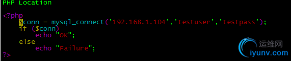

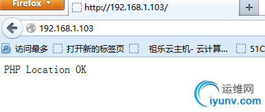

  编写测试代码,验证php是否可以连接数据库
[root@localhost ~]# cd /var/www/html
[root@localhost html]# vim index.php
[root@localhost html]# systemctl reload httpd.service

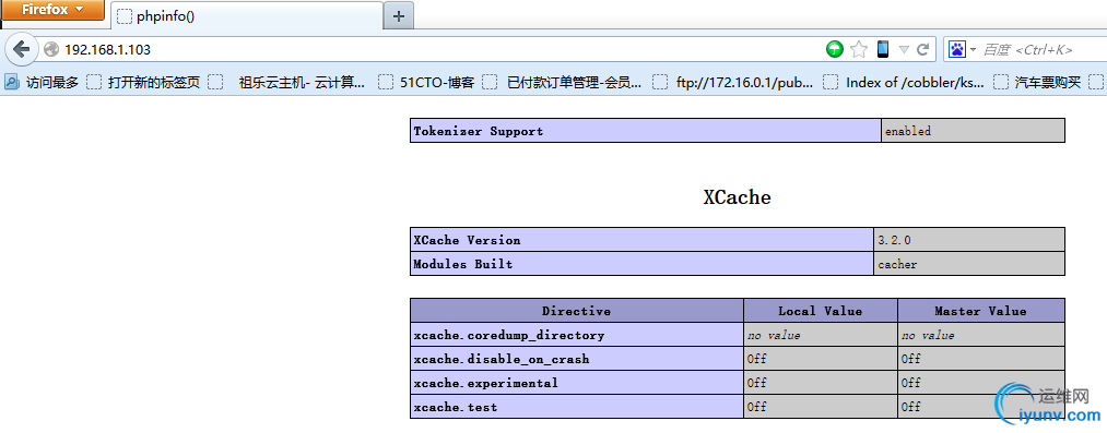

  3、xcache的编译安装
  xcache可以选择编译安装,但epel源中也有提供,这里用编译安装的方式。
[root@localhost ~]# yum groupinstall "Development Tools" "Server Platform Development" -y  //安装开发包组
[root@localhost ~]# yum install php-devel -y //安装xcache依赖php的包
  下载xcache压缩包
[root@localhost ~]# ls
  anaconda-ks.cfg  xcache-3.2.0.tar.bz2
[root@localhost ~]# tar xf xcache-3.2.0.tar.bz2
  anaconda-ks.cfg  xcache-3.2.0  xcache-3.2.0.tar.bz2
[root@localhost ~]# cd xcache-3.2.0/

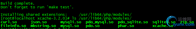

[root@localhost xcache-3.2.0]# phpize
[root@localhost xcache-3.2.0]# ./configure --enable-xcache --with-php-config=/usr/bin/php-config
[root@localhost xcache-3.2.0]# make && make install
[root@localhost xcache-3.2.0]# cp xcache.ini /etc/php.d/
[root@localhost xcache-3.2.0]# systemctl restart httpd.service
  浏览器访问,发现xcache已经安装完,对应版本为3.2.0

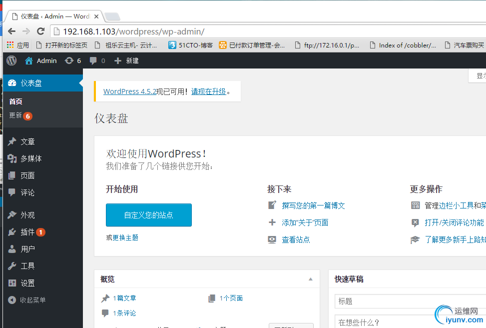

   下载wordpress(下载地址:https://wordpress.org/download/ )
      [root@localhost ~]# cd /web/vhost/test1
                [root@localhost test1]# unzip wordpress-4.3.1-zh_CN.zip
[root@localhost test1]# cd wordpress/

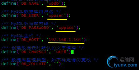

[root@localhost wordpress]# cp wp-config-sample.php wp-config.php  //复制示例的访问配置php文件,修改即可。
[root@localhost wordpress]# vim wp-config.php
[root@localhost ~]# systemctl restart httpd.service
  浏览器访问测试

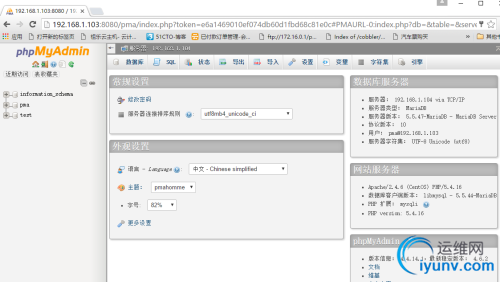

  下载方式:https://www.phpmyadmin.net/downloads/
       [root@localhost ~]# cd /web/vhost/test2
[root@localhost test2]# unzip phpMyAdmin-4.4.14.1-all-languages.zip
[root@localhost test2]# ln -sv phpMyAdmin-4.4.14.1-all-languages pma
  ‘pma’ -> ‘phpMyAdmin-4.4.14.1-all-languages’
[root@localhost test2]# cd pma

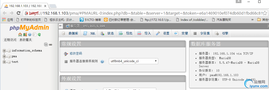

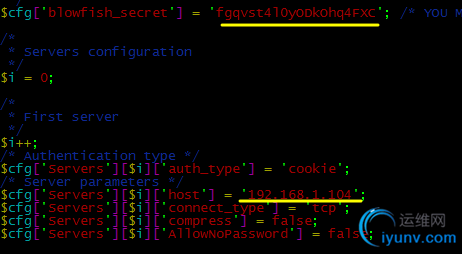

[root@localhost pma]# cp config.sample.inc.php config.inc.php
[root@localhost pma]# openssl rand -base64 15  //生成15个随机数
  fgqvst4l0yODkOhq4FXC
      [root@localhost pma]# vim config.inc.php  //把随机数添加到访问配置文件中

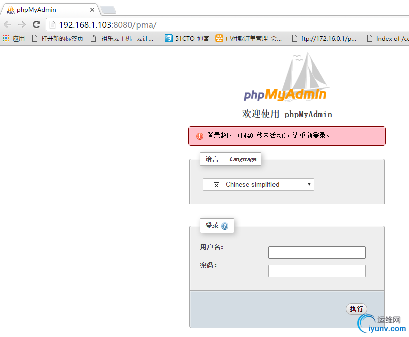

  用浏览器访问测试 192.168.1.103:8080/pma
  用户为 :  pma
  密码为 :  pmapass

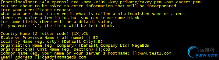

[root@localhost CA]# openssl req -new -x509 -key private/cakey.pem -out cacert.pem  //生成自己的自签证书

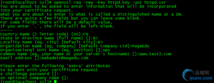

[root@localhost ssl]# openssl req -new -key httpd.key -out httpd.csr
[root@localhost ssl]# ls
  httpd.csr  httpd.key
[root@localhost ssl]# scp httpd.csr root@192.168.1.104:/tmp

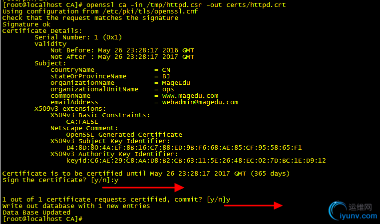

  c) 192.168.1.104  签署证书
[root@localhost CA]# openssl ca -in /tmp/httpd.csr -out certs/httpd.crt
[root@localhost CA]# scp certs/httpd.crt root@192.168.1.103:/etc/httpd/ssl/

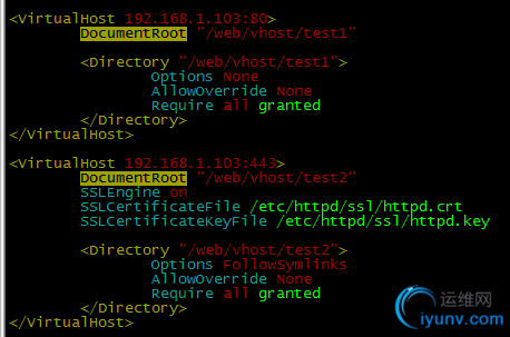

  2)、 192.168.1.103主机,配置httpd支持使用ssl,及使用的证书
  httpd.crt  httpd.csr  httpd.key
[root@localhost ssl]# yum install mod_ssl -y
[root@localhost ssl]# cd /etc/httpd/conf.d
[root@localhost conf.d]# ls
  autoindex.conf  php.conf  README  ssl.conf  userdir.conf  vhost.conf     welcome.conf
[root@localhost conf.d]# mv ssl.conf ssl.conf.backup
[root@localhost ~]# vim /etc/httpd/conf.d/vhost.conf

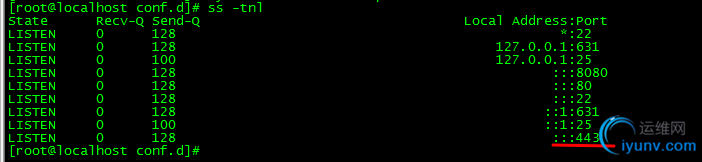

[root@localhost conf.d]# httpd -t
  Syntax OK
[root@localhost conf.d]# systemctl restart httpd.service
