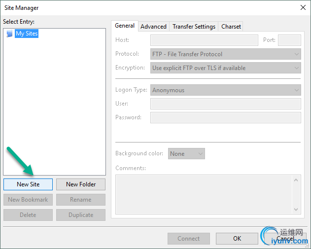

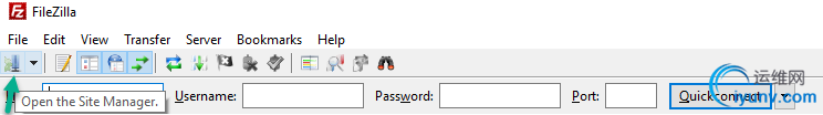

  When you first open FileZilla, find the Site Manager icon just below the word File, the left-most icon on the top row. Click it:
  A new window will open. Click the "New Site" button in the bottom right corner:
  Under "My Sites" a new icon with the words "New site" will appear. You can name it now or return later and use the Rename button.

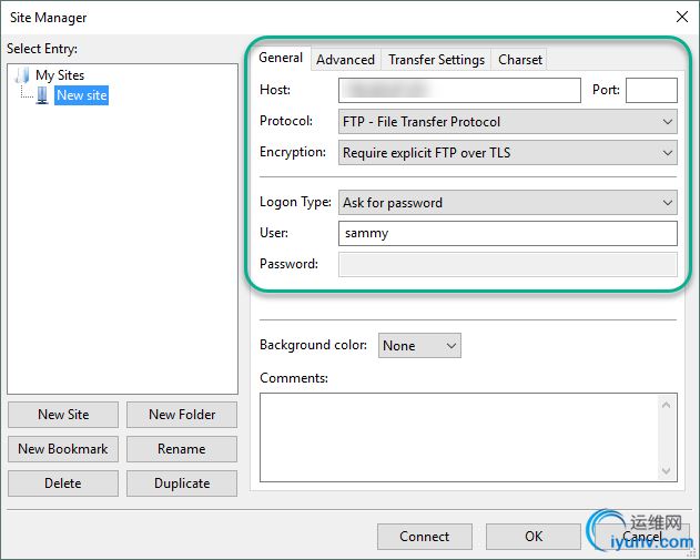

  You must fill out the "Host" field with the name or IP address. Under the "Encryption" drop down menu, select "Require explicit FTP over TLS".
  For "Logon Type", select "Ask for password". Fill in the FTP user you created in the "User" field:

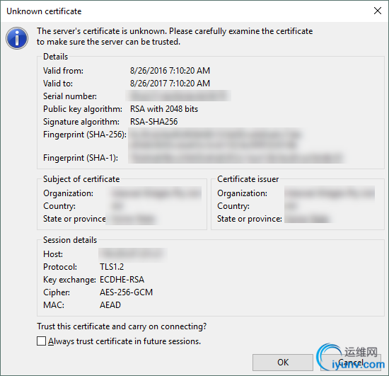

  Click "Connect" at the bottom of the interface. You will be asked for the user's password:
  Click "OK" to connect. You should now be connected with your server with TLS/SSL encryption.

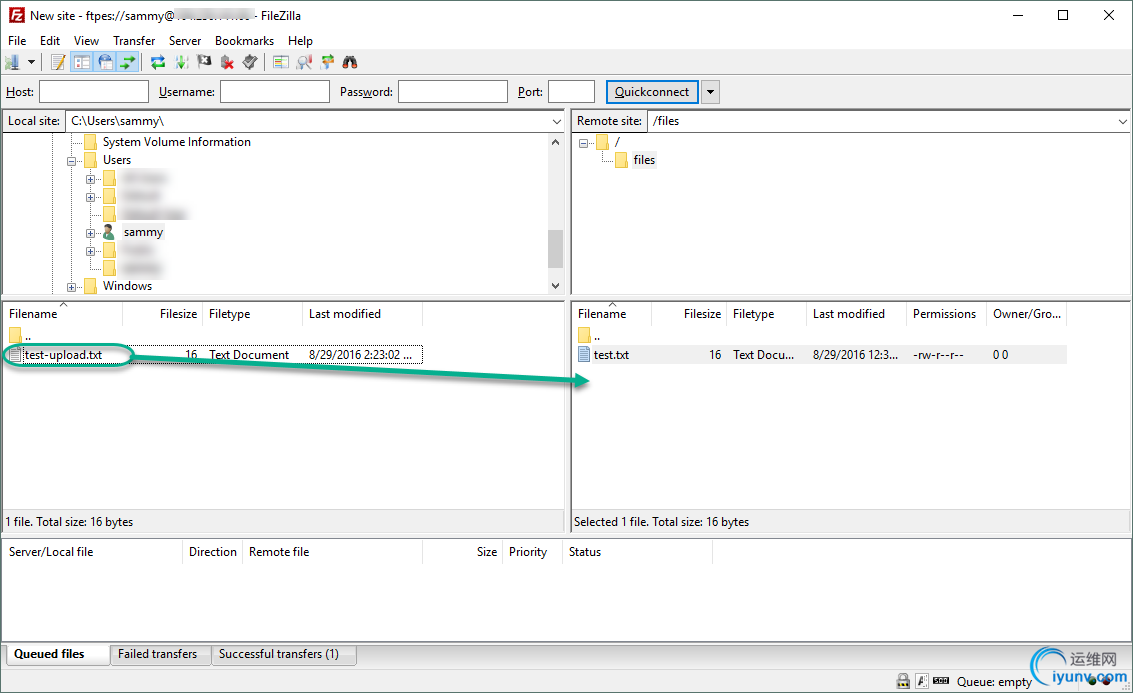

  When you’ve accepted the certificate, double-click the files folder and drag upload.txt to the left to confirm that you’re able to download files.

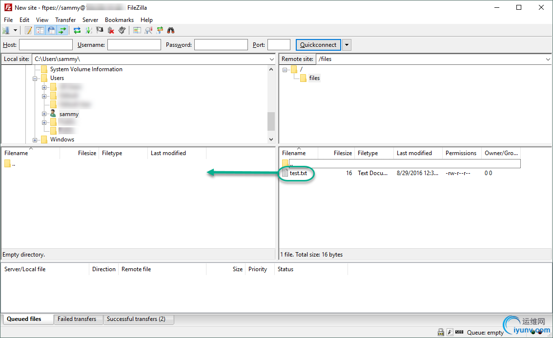

  When you’ve done that, right-click on the local copy, rename it to upload-tls.txt` and drag it back to the server to confirm that you can upload files.
  You’ve now confirmed that you can securely and successfully transfer files with SSL/TLS enabled.
