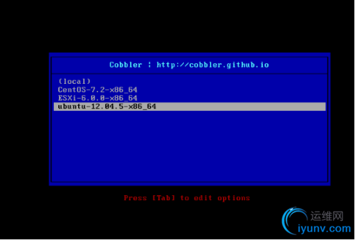

五、导入镜像并查看导入情况
1、导入镜像
  [root@cobbler-server ~]# mount /dev/cdrom /mnt/cdrom/
  mount: /dev/sr0 is write-protected, mounting read-only
  [root@cobbler-server ~]#cobbler import --path=/mnt/cdrom/ --name=ubuntu-12.04.5 --arch=x86_64
  task started: 2016-10-07_221950_import
  task started (id=Media import, time=Fri Oct  7 22:19:50 2016)
  Found a candidate signature: breed=freebsd, version=10.1
  Found a candidate signature: breed=freebsd, version=10.0
  Found a candidate signature: breed=freebsd, version=8.3
  Found a candidate signature: breed=freebsd, version=8.2
  Found a candidate signature: breed=freebsd, version=8.4
  Found a candidate signature: breed=freebsd, version=10.2
  Found a candidate signature: breed=freebsd, version=9.0
  Found a candidate signature: breed=freebsd, version=9.1
  Found a candidate signature: breed=freebsd, version=9.2
  Found a candidate signature: breed=freebsd, version=9.3
  Found a candidate signature: breed=ubuntu, version=precise
  running: /usr/bin/file /var/www/cobbler/ks_mirror/ubuntu-12.04.5-x86_64/dists/precise/Release
  received on stdout: /var/www/cobbler/ks_mirror/ubuntu-12.04.5-x86_64/dists/precise/Release: ASCII text
  received on stderr:
  Found a matching signature: breed=ubuntu, version=precise
  Adding distros from path /var/www/cobbler/ks_mirror/ubuntu-12.04.5-x86_64:
  creating new distro: ubuntu-12.04.5-x86_64
  trying symlink: /var/www/cobbler/ks_mirror/ubuntu-12.04.5-x86_64 -> /var/www/cobbler/links/ubuntu-12.04.5-x86_64
  creating new profile: ubuntu-12.04.5-x86_64
  associating repos
  checking for apt repo(s)
  adding apt repo for ubuntu-12.04.5-x86_64
  Added repos for ubuntu-12.04.5-x86_64
  *** TASK COMPLETE ***
  TFTP Boot Files                : {}
  Comment                        :
  DHCP Tag                       : default
  Distribution                   : ubuntu-12.04.5-x86_64
  Enable gPXE?                   : 0
  Enable PXE Menu?               : 1
  Fetchable Files                : {}
  Kernel Options                 : {}
  Kernel Options (Post Install)  : {}
  Kickstart                      : /var/lib/cobbler/kickstarts/sample.seed
  Kickstart Metadata             : {}
  Management Classes             : []
  Management Parameters          : <<inherit>>
  Name Servers                   : []
  Name Servers Search Path       : []
  Owners                         : ['admin']
  Parent Profile                 :
  Internal proxy                 :
  Red Hat Management Key         : <<inherit>>
  Red Hat Management Server      : <<inherit>>
  Repos                          : []
  Server Override                : <<inherit>>
  Template Files                 : {}
  Virt Auto Boot                 : 1
  Virt Bridge                    : xenbr0
  Virt CPUs                      : 1
  Virt Disk Driver Type          : raw
  Virt File Size(GB)             : 5
  Virt Path                      :
  Virt RAM (MB)                  : 512
  Virt Type                      : kvm

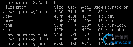

2、lvm分区配置
  绿色标记部分是最重要的,定制分区的配置,以上是普通分区方式
  如果是lvm分区方式,用以下配置
d-i partman-auto/disk string /dev/sda#指定磁盘
d-i partman-auto/method string lvm#分区格式lvm还是普通分区还是raid
d-i partman-auto/choose_recipe select fsm
d-i partman-lvm/device_remove_lvm boolean true
d-i partman-md/device_remove_md boolean true
d-i partman-auto-lvm/no_boot boolean true
d-i partman-auto-lvm/new_vg_name string vg0
d-i partman-auto/expert_recipe string \
fsm :: \
1024 100% 1024 linux-swap method{ swap } \
format{ } $lvmok{ } lv_name{ swap } \
2048 2048 2048 ext4 method{ lvm } \
$lvmok{ } mountpoint{ /home } lv_name{ home } \
format{ } use_filesystem{ } filesystem{ ext4 } \
10240 10240 10240 ext4 method{ lvm } \
$lvmok{ } mountpoint{ / } lv_name{ root } \
options/relatime{ relatime } \
768 1024 1024 ext4 method{ lvm } \
$lvmok{ } mountpoint{ /tmp } lv_name{ tmp } \
1 2048 1000000000 ext4 method{ lvm } \
$lvmok{ } mountpoint{ /www } lv_name{ www } \
d-i partman-lvm/confirm_nooverwrite boolean true
d-i partman-lvm/confirm boolean true
d-i partman-partitioning/confirm_write_new_label boolean true
d-i partman/confirm_nooverwrite boolean true
d-i partman/confirm boolean true
d-i partman/choose_partition \
    select Finish partitioning and write changes to disk    #保存分区

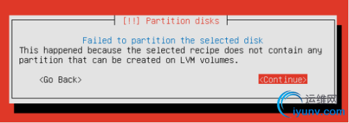

注:
$lvmok{ }必须存在,不然安装会报错无法继续
不存在这个选项cobbler又会报错
{'code': u'VFFSL(SL,"lvmok",True)',
  'exc_val': NotFound(u"cannot find 'lvmok'",),
  'lineCol': (60, 11),
  'rawCode': u'$lvmok',
  'time': 'Sun Oct  9 23:43:14 2016'}]
不知道是不是cobbler的bug
