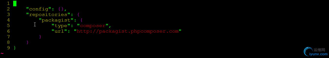

  if you need,please modify chinese source ,or it will be slow,if there is a ladder,you can skip,like this:
composer config -g repositories.packagist composer http://packagist.phpcomposer.com  申请github token,其他项目也会用到,不然会看到

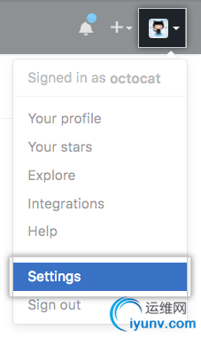

    •   In the top right corner of any page, click your profile photo, then click Settings. DSC0000.png

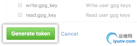

    •   Click Generate token.

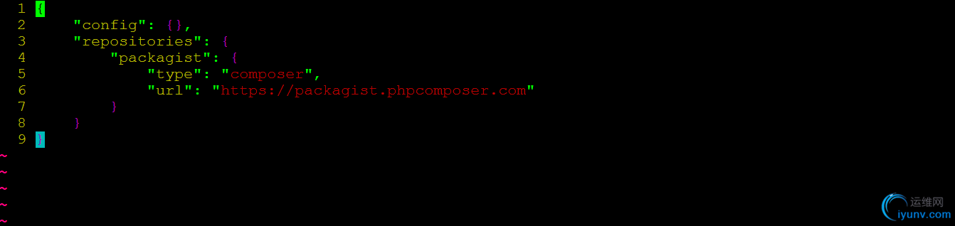

  更改composer 源(更改成https):
vim  ~/.composer/config.json
  更改为:
