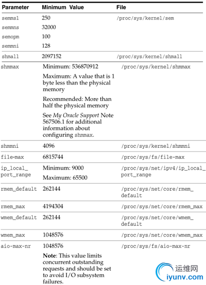

  4、内核参数要求
Note: If the current value of any parameter is higher than the value listed in this table, then do not change the value of that parameter.本文原始出处:江健龙的技术博客http://jiangjianlong.blog.51cto.com/3735273/1832986
修改方法:
create or edit the  /etc/sysctl.conf file, and add or edit lines similar to the following:
fs.aio-max-nr = 1048576
fs.file-max = 6815744
kernel.sem = 250 32000 100 128
net.ipv4.ip_local_port_range = 9000 65500
net.core.rmem_default = 262144
net.core.rmem_max = 4194304
net.core.wmem_default = 262144
net.core.wmem_max = 1048576
Note if any of the current values are larger than the
minimum value, then specify the larger value

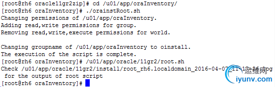

4、使用root登录执行脚本

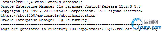

4、登录EM
