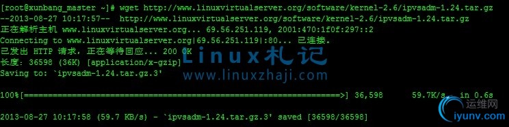

2、下载 ipvsadm
[root@xunbang_master ~]# wget http://www.linuxvirtualserver.org/software/kernel-2.6/ipvsadm-1.24.tar.gz

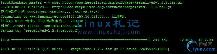

1、下载keepalived
[root@xunbang_master ~]# wget http://www.keepalived.org/software/keepalived-1.2.2.tar.gz

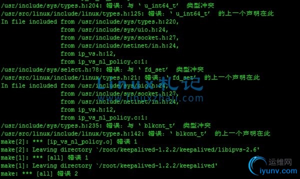

如果报错,如图所示这样
注意:

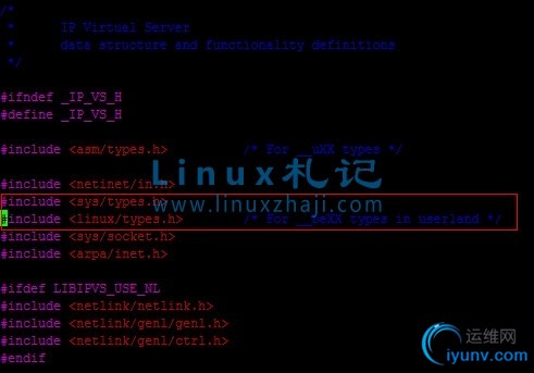

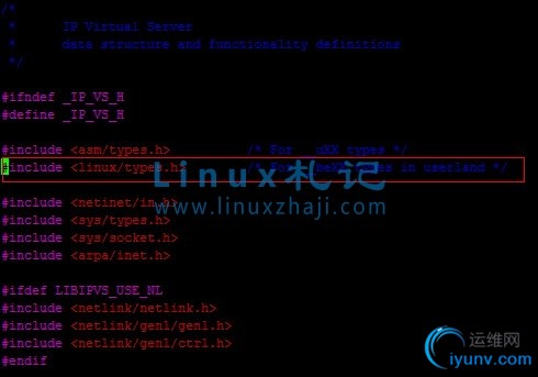

把#include linux/types.h /* For __beXX types in userland */
移到#include sys/types.h 这行的下面
再编译就可以通过了。(这个可能是keepalived版本问题)
[root@xunbang_master keepalived-1.2.2]# vim keepalived/libipvs-2.6/ip_vs.h

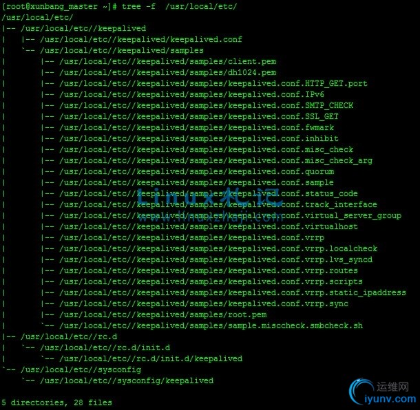

先看下有没有文件
[root@xunbang_master ~]# cp /usr/local/etc/rc.d/init.d/keepalived /etc/rc.d/init.d/
[root@xunbang_master ~]# cp /usr/local/etc/sysconfig/keepalived /etc/sysconfig/
[root@xunbang_master ~]# mkdir /etc/keepalived
[root@xunbang_master ~]# cp /usr/local/etc/keepalived/keepalived.conf /etc/keepalived/
[root@xunbang_master ~]# cp /usr/local/sbin/keepalived /usr/sbin/
